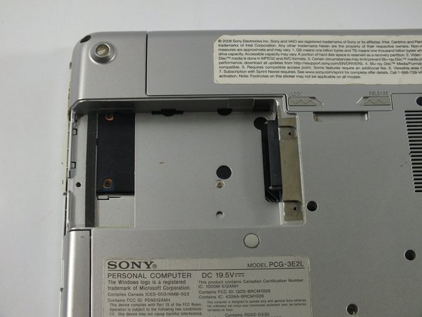

    • Using a #00 Phillips screwdriver, remove the screw
  2. Sony VAIO PCG-3E2L Hard Drive Replacement: crwdns2935265:02crwdnd2935265:01crwdnd2935265:01crwdne2935265:0
    • Remove the cover
  3. Sony VAIO PCG-3E2L Hard Drive Replacement: crwdns2935265:03crwdnd2935265:01crwdnd2935265:01crwdne2935265:0

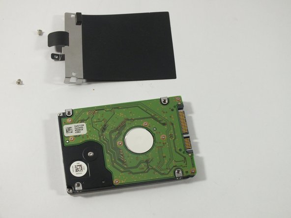

  4. Sony VAIO PCG-3E2L Hard Drive Replacement: crwdns2935265:04crwdnd2935265:01crwdnd2935265:02crwdne2935265:0 Sony VAIO PCG-3E2L Hard Drive Replacement: crwdns2935265:04crwdnd2935265:02crwdnd2935265:02crwdne2935265:0
    • Grab the black plastic handle and pull the hard drive out slowly.
    • Only pull the hard drive horizontally. Do not lift the hard drive vertically
  5. Sony VAIO PCG-3E2L Hard Drive Replacement: crwdns2935265:05crwdnd2935265:01crwdnd2935265:02crwdne2935265:0 Sony VAIO PCG-3E2L Hard Drive Replacement: crwdns2935265:05crwdnd2935265:02crwdnd2935265:02crwdne2935265:0
