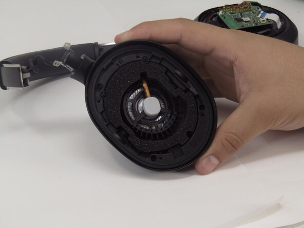

    • Gently press the pad down toward the center of the driver housing to expose the crease connecting the pad to the driver housing.
    • Carefully insert the flat end of the nylon spudger into the seam between the crease of the ear pad and the driver housing.
    • Pry around the perimeter of the ear pad to disengage the retaining clips until the ear pad fully releases.
    • Remove the ear pad.
