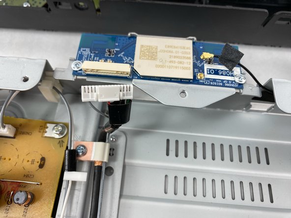

  11. Sony UBP-UX80 Wi-Fi Card Replacement, Wi-Fi Card: crwdns2935265:011crwdnd2935265:01crwdnd2935265:02crwdne2935265:0 Sony UBP-UX80 Wi-Fi Card Replacement, Wi-Fi Card: crwdns2935265:011crwdnd2935265:02crwdnd2935265:02crwdne2935265:0
    • Disconnect the power connection by pulling it straight back and out of the card.
  12. Sony UBP-UX80 Wi-Fi Card Replacement: crwdns2935265:012crwdnd2935265:01crwdnd2935265:02crwdne2935265:0 Sony UBP-UX80 Wi-Fi Card Replacement: crwdns2935265:012crwdnd2935265:02crwdnd2935265:02crwdne2935265:0
    • Remove the gold-colored connection, remove the tape, and pull it off using the wire. Be gentle because the wire is very small as is the connection.
  13. Sony UBP-UX80 Wi-Fi Card Replacement: crwdns2935265:013crwdnd2935265:01crwdnd2935265:01crwdne2935265:0
    • Use a Phillips #2 screwdriver to remove the two 4.6 mm screws that secure the card.
  14. Sony UBP-UX80 Wi-Fi Card Replacement: crwdns2935265:014crwdnd2935265:01crwdnd2935265:01crwdne2935265:0
    • Lift up slightly on the back of the card, and pull out (toward the back of the chassis).
