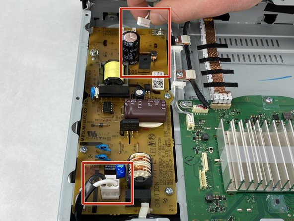

  5. Sony UBP-UX80 Power Board Replacement, Power Board: crwdns2935265:05crwdnd2935265:01crwdnd2935265:02crwdne2935265:0 Sony UBP-UX80 Power Board Replacement, Power Board: crwdns2935265:05crwdnd2935265:02crwdnd2935265:02crwdne2935265:0
    • Unplug device before starting. Try not to touch any exposed wires or traces on the board.
    • Disconnect the power cable connector and motherboard connector from the power board.

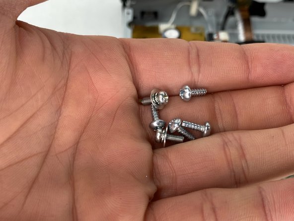

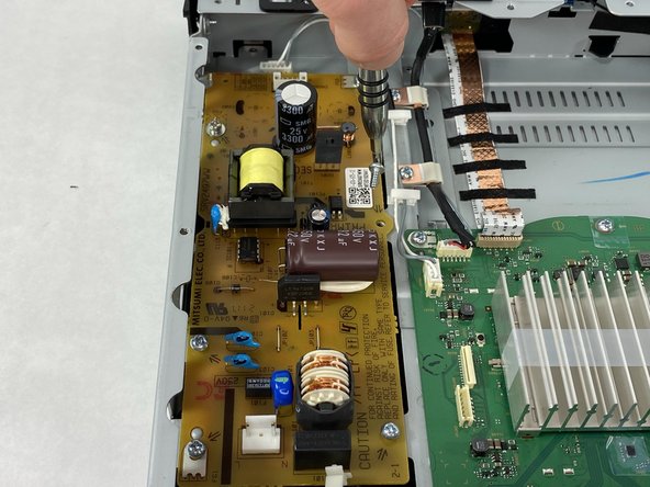

  6. Sony UBP-UX80 Power Board Replacement: crwdns2935265:06crwdnd2935265:01crwdnd2935265:03crwdne2935265:0 Sony UBP-UX80 Power Board Replacement: crwdns2935265:06crwdnd2935265:02crwdnd2935265:03crwdne2935265:0 Sony UBP-UX80 Power Board Replacement: crwdns2935265:06crwdnd2935265:03crwdnd2935265:03crwdne2935265:0
    • Use a Phillips #2 screwdriver to remove the six 10.5 mm screws that secure the board.
    • Note that there are two (2) screws with washers attached to them at the top of the board, please know where they go.
