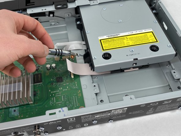

    • Find the eleven 10.5 mm silver screws and two 6 mm black screws on the perimeter of the silver cover plate.
    • Remove the silver screws using a Phillips #2 screwdriver and the black ones using a Phillips #1 screwdriver.
    • Life the back of the cover up and off of the chasis.

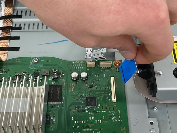

  5. Sony UBP-UX80 Disc Drive Assembly Replacement, Disc Drive Assembly: crwdns2935265:05crwdnd2935265:01crwdnd2935265:02crwdne2935265:0 Sony UBP-UX80 Disc Drive Assembly Replacement, Disc Drive Assembly: crwdns2935265:05crwdnd2935265:02crwdnd2935265:02crwdne2935265:0
    • Find and remove the three ribbon connections leading to the motherboard.
    • Gently pull straight up. Be careful because ribbon cables are fragile.

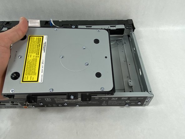

  6. Sony UBP-UX80 Disc Drive Assembly Replacement: crwdns2935265:06crwdnd2935265:01crwdnd2935265:02crwdne2935265:0 Sony UBP-UX80 Disc Drive Assembly Replacement: crwdns2935265:06crwdnd2935265:02crwdnd2935265:02crwdne2935265:0
    • Use a Phillips #2 screwdriver to remove the four 10.5 mm screws.
  7. Sony UBP-UX80 Disc Drive Assembly Replacement: crwdns2935265:07crwdnd2935265:01crwdnd2935265:02crwdne2935265:0 Sony UBP-UX80 Disc Drive Assembly Replacement: crwdns2935265:07crwdnd2935265:02crwdnd2935265:02crwdne2935265:0
    • Lift the back of the assembly slightly, and pull it back and out of the case to remove it.
