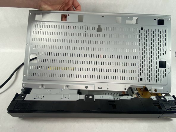

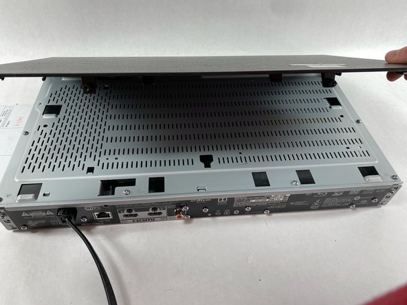

    • Find the eleven 10.5 mm silver screws and two 6 mm black screws on the perimeter of the silver cover plate.
    • Remove the silver screws using a Phillips #2 screwdriver and the black ones using a Phillips #1 screwdriver.
    • Life the back of the cover up and off of the chasis.

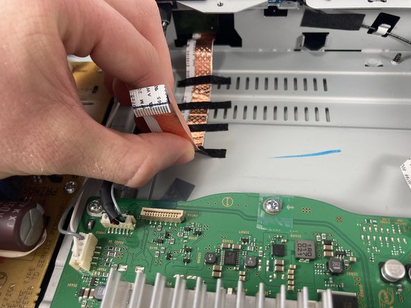

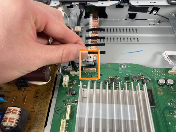

    • Toward the panel there is a ribbon cable with 4 small black pieces of tape holding it down
    • Pull directly up on the ribbon cable to disconnect it from the motherboard
    • Gently pull the cable back away from the motherboard pulling the tape off with it
  6. Sony UBP-UX80 Button PCB Replacement: crwdns2935265:06crwdnd2935265:01crwdnd2935265:01crwdne2935265:0
    • Once all pieces of tape have been pulled up, the ribbon cable should look like this.

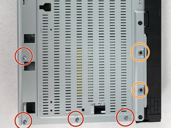

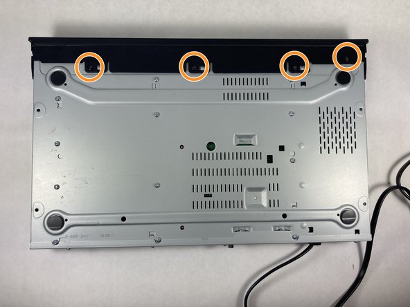

    • There are screws on every side of the front panel holding it in. Use a #2 Phillips head screwdriver to remove the nine screws.
    • Unscrew the three 10.5 mm long ph #2 screws on the top.
    • Unscrew the four 10.5 mm long ph #2 screws on the bottom.
  8. Sony UBP-UX80 Button PCB Replacement: crwdns2935265:08crwdnd2935265:01crwdnd2935265:02crwdne2935265:0 Sony UBP-UX80 Button PCB Replacement: crwdns2935265:08crwdnd2935265:02crwdnd2935265:02crwdne2935265:0

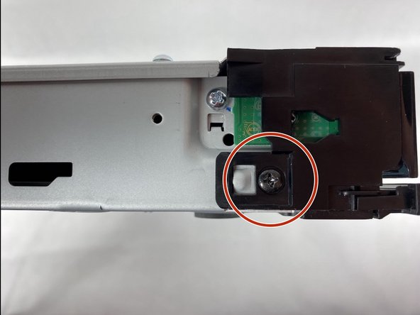

    • Use a Phillips #2 screwdriver to remove the 10.5 mm screws, one on each side of the device.

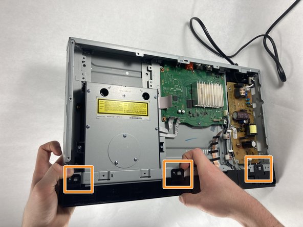

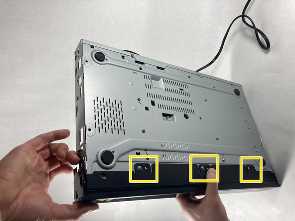

    • Lift tab on the left side of the device
    • Work your way right, lifting the next tabs. One on the bottom and one the Top
    • Continue working the tabs on the top and bottom, keeping them from snapping back in place.
  10. Sony UBP-UX80 Button PCB Replacement: crwdns2935265:010crwdnd2935265:01crwdnd2935265:01crwdne2935265:0
    • Once all tabs are disconnected, pull the front panel forward to fully disconnect it

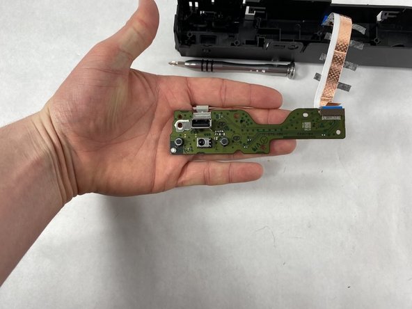

    • Once the Front Panel is removed, look to the inside of it and find a green circuit board which will be the Personal Control Board (PCB).
  12. Sony UBP-UX80 Button PCB Replacement: crwdns2935265:012crwdnd2935265:01crwdnd2935265:01crwdne2935265:0
    • Remove the four 10mm screws holding the PCB in place and unscrew them using the #2 Phillips head screwdriver.
  13. Sony UBP-UX80 Button PCB Replacement: crwdns2935265:013crwdnd2935265:01crwdnd2935265:02crwdne2935265:0 Sony UBP-UX80 Button PCB Replacement: crwdns2935265:013crwdnd2935265:02crwdnd2935265:02crwdne2935265:0
    • Lift up on the bottom of the silver bracket and pull out to remove the PCB.
