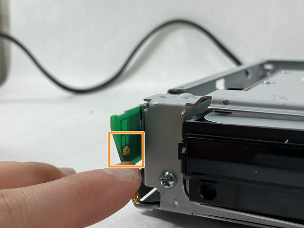

  12. Sony UBP-UX80 Bluetooth Card Replacement: crwdns2935265:012crwdnd2935265:01crwdnd2935265:02crwdne2935265:0 Sony UBP-UX80 Bluetooth Card Replacement: crwdns2935265:012crwdnd2935265:02crwdnd2935265:02crwdne2935265:0
    • Gently remove the small brass connection, remove it, being careful not to break the connector or the wire as they are very small.
    • Once the wire has been gently removed, this should be the end result.
