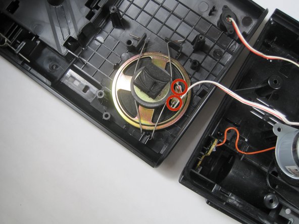

  3. Sony TCM-919 Cassette-Corder Speaker Replacement, Desolder Speaker Wires: crwdns2935265:03crwdnd2935265:01crwdnd2935265:02crwdne2935265:0 Sony TCM-919 Cassette-Corder Speaker Replacement, Desolder Speaker Wires: crwdns2935265:03crwdnd2935265:02crwdnd2935265:02crwdne2935265:0
    • Look to the back of the top cover.
    • Desolder the two wires from the speaker.

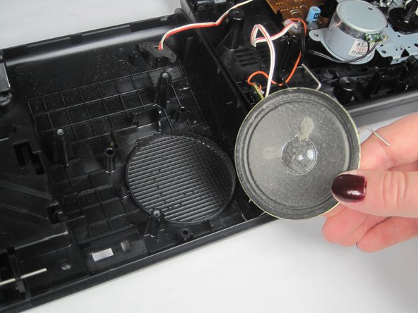

  4. Sony TCM-919 Cassette-Corder Speaker Replacement, Remove Speaker: crwdns2935265:04crwdnd2935265:01crwdnd2935265:02crwdne2935265:0 Sony TCM-919 Cassette-Corder Speaker Replacement, Remove Speaker: crwdns2935265:04crwdnd2935265:02crwdnd2935265:02crwdne2935265:0
    • Squeeze the two prongs holding the speaker in place and remove the metal piece.
    • Remove the speaker by gently lifting it up from the cover and pulling.
