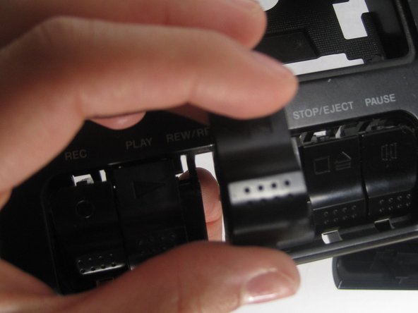

  3. Sony TCM-919 Cassette-Corder Operating Buttons Replacement, Locate Buttons: crwdns2935265:03crwdnd2935265:01crwdnd2935265:01crwdne2935265:0
    • Look to the back of the top cover and locate the broken button(s).
  4. Sony TCM-919 Cassette-Corder Operating Buttons Replacement, Detach Buttons: crwdns2935265:04crwdnd2935265:01crwdnd2935265:02crwdne2935265:0 Sony TCM-919 Cassette-Corder Operating Buttons Replacement, Detach Buttons: crwdns2935265:04crwdnd2935265:02crwdnd2935265:02crwdne2935265:0
    • Use a splunger tool to undo the two clips that belong to any broken buttons.
    • Turn the device over and using your finger, push out the loose button.
