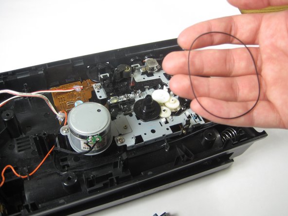

  3. Sony TCM-919 Cassette-Corder Motherboard Replacement, Remove 3-Digit Tape Counter: crwdns2935265:03crwdnd2935265:01crwdnd2935265:02crwdne2935265:0 Sony TCM-919 Cassette-Corder Motherboard Replacement, Remove 3-Digit Tape Counter: crwdns2935265:03crwdnd2935265:02crwdnd2935265:02crwdne2935265:0
    • Locate the 3-digit tape counter and gently push the tabs apart releasing the counter.
    • Pull the 3-digit tape counter out.
    • Remove the rubber band attaching the 3-digit tape counter to the cassette head.

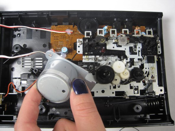

  4. Sony TCM-919 Cassette-Corder Motherboard Replacement, Remove Motor: crwdns2935265:04crwdnd2935265:01crwdnd2935265:02crwdne2935265:0 Sony TCM-919 Cassette-Corder Motherboard Replacement, Remove Motor: crwdns2935265:04crwdnd2935265:02crwdnd2935265:02crwdne2935265:0
    • Remove the screws as indicated in the picture using the Phillips Head screwdriver.
    • Pull the loosened motor out of the device, and set the motor aside.

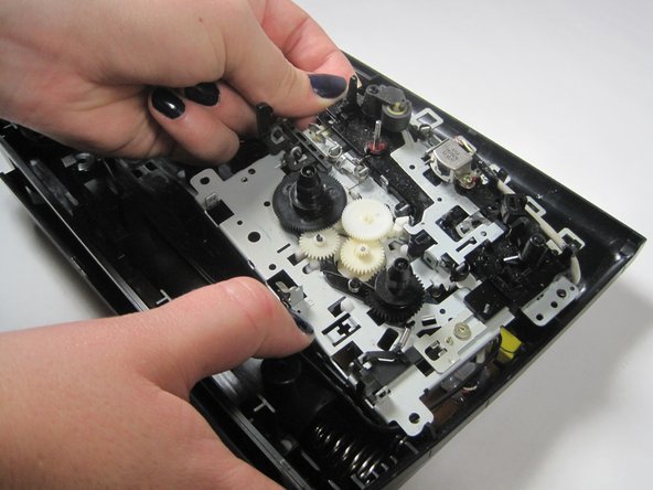

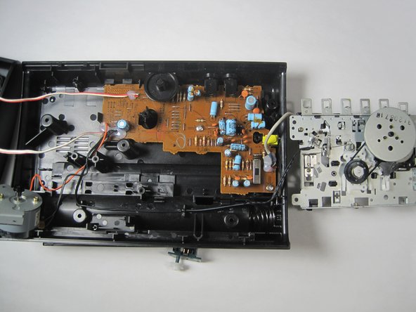

  5. Sony TCM-919 Cassette-Corder Motherboard Replacement, Remove the Tape Deck: crwdns2935265:05crwdnd2935265:01crwdnd2935265:03crwdne2935265:0 Sony TCM-919 Cassette-Corder Motherboard Replacement, Remove the Tape Deck: crwdns2935265:05crwdnd2935265:02crwdnd2935265:03crwdne2935265:0 Sony TCM-919 Cassette-Corder Motherboard Replacement, Remove the Tape Deck: crwdns2935265:05crwdnd2935265:03crwdnd2935265:03crwdne2935265:0
    • Removes the 3, 5.95mm screws using the Phillips Head screwdriver as indicated by picture 1.
    • Push firmly on the tabs and lift the tape deck out.
    • Set the tape deck aside.

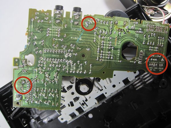

  8. Sony TCM-919 Cassette-Corder Motherboard Replacement, Desolder Wires From Motherboard: crwdns2935265:08crwdnd2935265:01crwdnd2935265:02crwdne2935265:0 Sony TCM-919 Cassette-Corder Motherboard Replacement, Desolder Wires From Motherboard: crwdns2935265:08crwdnd2935265:02crwdnd2935265:02crwdne2935265:0
    • Remove the motherboard from case.
    • Flip the motherboard around so that the metallic green side is facing you.
    • Desolder the points indicated in picture 2. This should free the wires connected to the motherboard.
    • Remove the motherboard by pulling it out of the device cavity.
