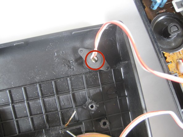

  3. Sony TCM-919 Cassette-Corder Microphone Replacement, Desolder Microphone Wires: crwdns2935265:03crwdnd2935265:01crwdnd2935265:02crwdne2935265:0 Sony TCM-919 Cassette-Corder Microphone Replacement, Desolder Microphone Wires: crwdns2935265:03crwdnd2935265:02crwdnd2935265:02crwdne2935265:0
    • Look to the back of the top cover.
    • Desolder the two wires connected to the mircophone using the soldering station.

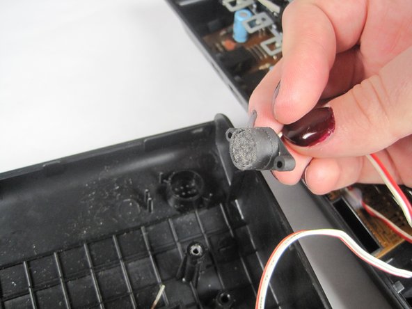

  4. Sony TCM-919 Cassette-Corder Microphone Replacement, Remove Microphone: crwdns2935265:04crwdnd2935265:01crwdnd2935265:02crwdne2935265:0 Sony TCM-919 Cassette-Corder Microphone Replacement, Remove Microphone: crwdns2935265:04crwdnd2935265:02crwdnd2935265:02crwdne2935265:0
    • Gently remove the rubber top from the two plastic knobs that hold the microphone in place.
    • Remove the microphone by pulling up.
