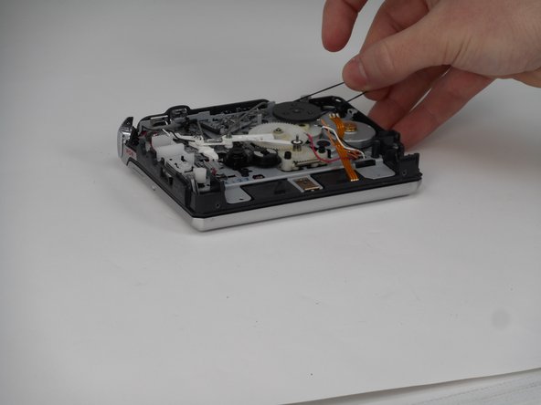

  9. Sony TCM-450 Capstan Belt Replacement, Belt for Capstan: crwdns2935265:09crwdnd2935265:01crwdnd2935265:02crwdne2935265:0 Sony TCM-450 Capstan Belt Replacement, Belt for Capstan: crwdns2935265:09crwdnd2935265:02crwdnd2935265:02crwdne2935265:0
    • After removing the PCB, simply remove the belt by pulling the belt out and away from the Capstan.
    • Make sure to not pull the belt to much or it can hit you in the eye as the belt is made of rubber.
