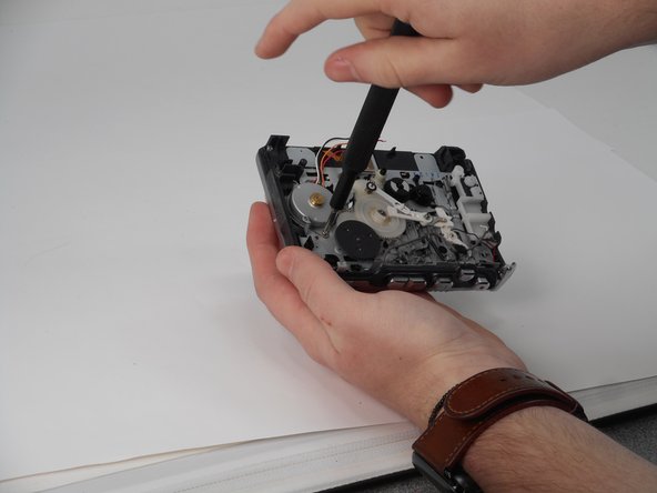

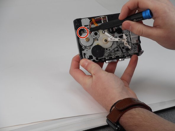

  10. Sony TCM-450 Capstan / Reel Motor Replacement: crwdns2935265:010crwdnd2935265:01crwdnd2935265:03crwdne2935265:0 Sony TCM-450 Capstan / Reel Motor Replacement: crwdns2935265:010crwdnd2935265:02crwdnd2935265:03crwdne2935265:0 Sony TCM-450 Capstan / Reel Motor Replacement: crwdns2935265:010crwdnd2935265:03crwdnd2935265:03crwdne2935265:0
    • Remove the two 1.9 mm screws with a Phillips #00 screwdriver.

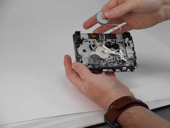

  11. Sony TCM-450 Capstan / Reel Motor Replacement: crwdns2935265:011crwdnd2935265:01crwdnd2935265:02crwdne2935265:0 Sony TCM-450 Capstan / Reel Motor Replacement: crwdns2935265:011crwdnd2935265:02crwdnd2935265:02crwdne2935265:0
    • Remove the motor from where it is seated.
