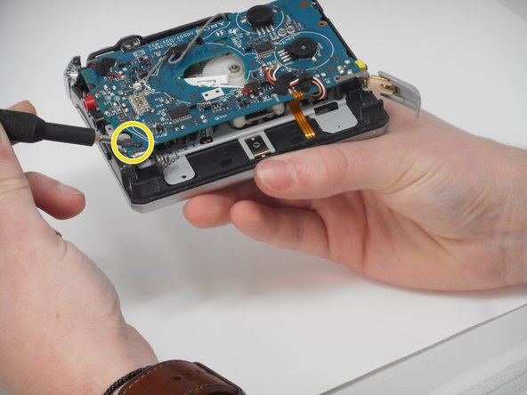

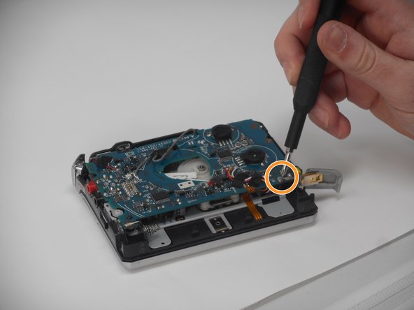

  4. Sony TCM-450 Battery Cover Replacement, Battery Cover: crwdns2935265:04crwdnd2935265:01crwdnd2935265:03crwdne2935265:0 Sony TCM-450 Battery Cover Replacement, Battery Cover: crwdns2935265:04crwdnd2935265:02crwdnd2935265:03crwdne2935265:0 Sony TCM-450 Battery Cover Replacement, Battery Cover: crwdns2935265:04crwdnd2935265:03crwdnd2935265:03crwdne2935265:0
    • Carefully remove the three inner screws as shown from the circuit board to loosen it.
    • Remove the following screws in this order:
    • A 3.4 mm Phillips #00
    • A 4.6 mm Phillips #00
    • A 9.7 mm Phillips #0

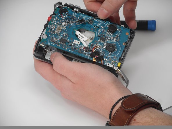

  5. Sony TCM-450 Battery Cover Replacement: crwdns2935265:05crwdnd2935265:01crwdnd2935265:02crwdne2935265:0 Sony TCM-450 Battery Cover Replacement: crwdns2935265:05crwdnd2935265:02crwdnd2935265:02crwdne2935265:0
    • Carefully move the gray wire out of its slot on the circuit board before continuing.

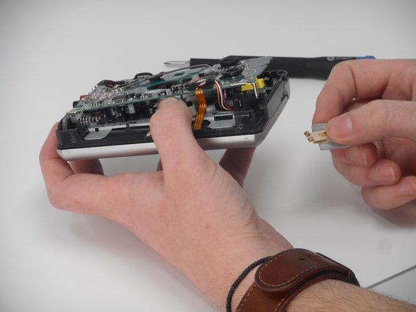

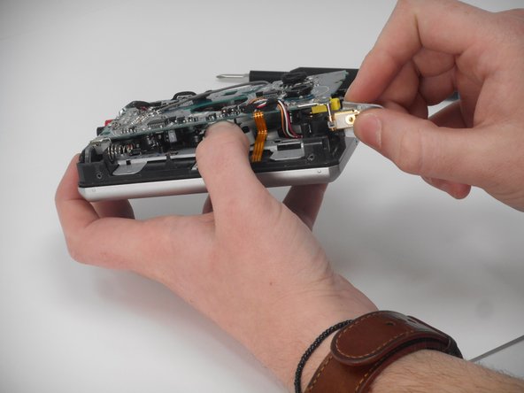

  6. Sony TCM-450 Battery Cover Replacement: crwdns2935265:06crwdnd2935265:01crwdnd2935265:03crwdne2935265:0 Sony TCM-450 Battery Cover Replacement: crwdns2935265:06crwdnd2935265:02crwdnd2935265:03crwdne2935265:0 Sony TCM-450 Battery Cover Replacement: crwdns2935265:06crwdnd2935265:03crwdnd2935265:03crwdne2935265:0
    • Gently lift the circuit board and gently slide the battery cover down off of the hinge pin as shown.
    • Caution: Do not lift the circuit board too high or wires will be torn and damaged.
