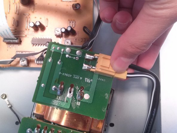

    • Locate the power cord connection and disconnect it. To remove it, press down on the plastic tab and slowly slide it out of the socket.

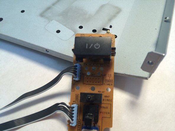

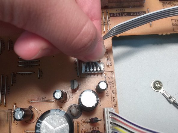

    • Locate the cords that are connected to the power button. Remove the connection by tugging on the cords gently, releasing them from the main PC board.

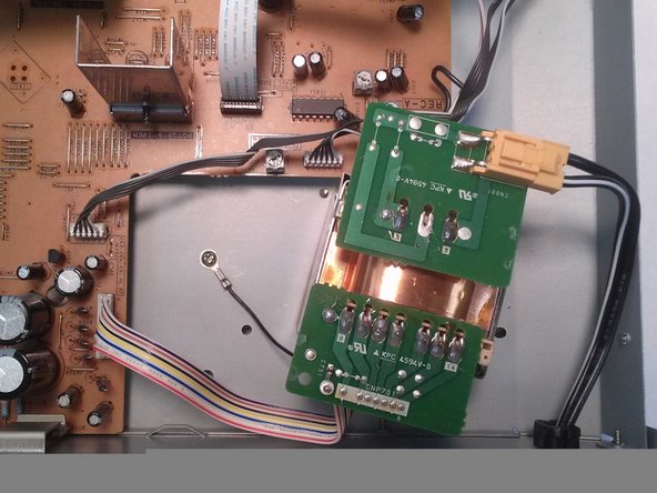

    • Unscrew all five 7.5mm Phillips head screws from the PCB (printed circuit board) behind the power switch.
  6. Sony TC-WE825S Power Button Replacement: crwdns2935265:06crwdnd2935265:01crwdnd2935265:01crwdne2935265:0
    • Use forceps to gently pry the PCB from the frame of the cassette player.

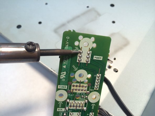

    • Use a soldering iron to desolder the power switch’s terminals and connections. Remove the power switch, replace it, and solder it back together. Repeat these steps in reverse order to put the cassette player back together.
