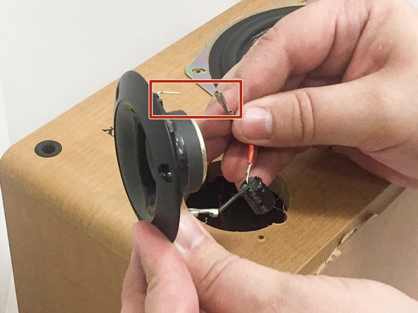

    • Remove the crimps from the tweeter speaker.
    • If its not connected too tightly the crimps can be removed by hand pressure only.
    • If its too tight to be removed by hand, then you can use a pair of pliers to removed the crimps.
    • Never remove by pulling on the cables. Always pull by the metal crimps.

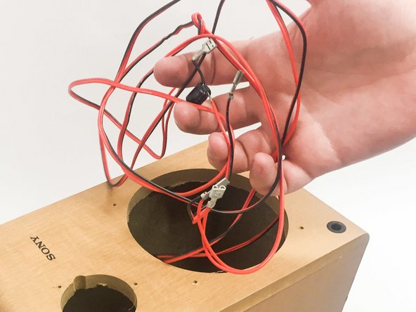

  4. Sony SS-CCP1 Speaker Replacement: crwdns2935265:04crwdnd2935265:01crwdnd2935265:03crwdne2935265:0 Sony SS-CCP1 Speaker Replacement: crwdns2935265:04crwdnd2935265:02crwdnd2935265:03crwdne2935265:0 Sony SS-CCP1 Speaker Replacement: crwdns2935265:04crwdnd2935265:03crwdnd2935265:03crwdne2935265:0
    • Remove the crimps from the 12cm loudspeaker.

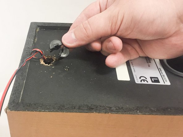

  5. Sony SS-CCP1 Speaker Replacement: crwdns2935265:05crwdnd2935265:01crwdnd2935265:02crwdne2935265:0 Sony SS-CCP1 Speaker Replacement: crwdns2935265:05crwdnd2935265:02crwdnd2935265:02crwdne2935265:0
    • Remove the grommet using an object with a flat edge.
    • The grommet is not made of rubber, it is made of plastic. Be careful when removing it, as it can break easily.
  6. Sony SS-CCP1 Speaker Replacement: crwdns2935265:06crwdnd2935265:01crwdnd2935265:02crwdne2935265:0 Sony SS-CCP1 Speaker Replacement: crwdns2935265:06crwdnd2935265:02crwdnd2935265:02crwdne2935265:0
    • Feed the speaker cable through the front of the box.
