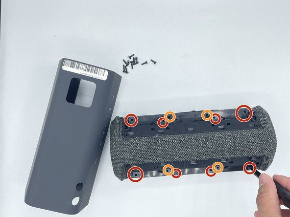

  3. Sony SRS-XE200 Microphone Replacement: crwdns2935265:03crwdnd2935265:01crwdnd2935265:02crwdne2935265:0 Sony SRS-XE200 Microphone Replacement: crwdns2935265:03crwdnd2935265:02crwdnd2935265:02crwdne2935265:0
    • Remove the eight 1 mm screws that connect the motherboard case and the speaker case with a Phillips #1 screwdriver.
    • Remove the four 0.8 mm screws that connect the motherboard case and the speaker case with a Phillips #1 screwdriver.

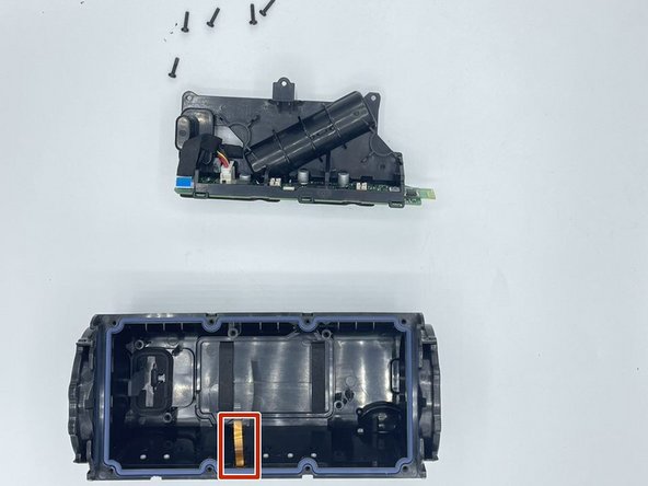

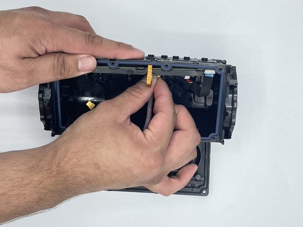

  4. Sony SRS-XE200 Microphone Replacement: crwdns2935265:04crwdnd2935265:01crwdnd2935265:02crwdne2935265:0 Sony SRS-XE200 Microphone Replacement: crwdns2935265:04crwdnd2935265:02crwdnd2935265:02crwdne2935265:0
    • Unplug the colored wires from the motherboard to detach the speaker assembly.

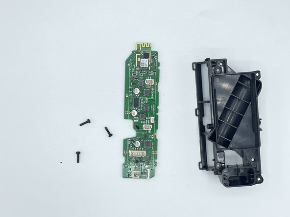

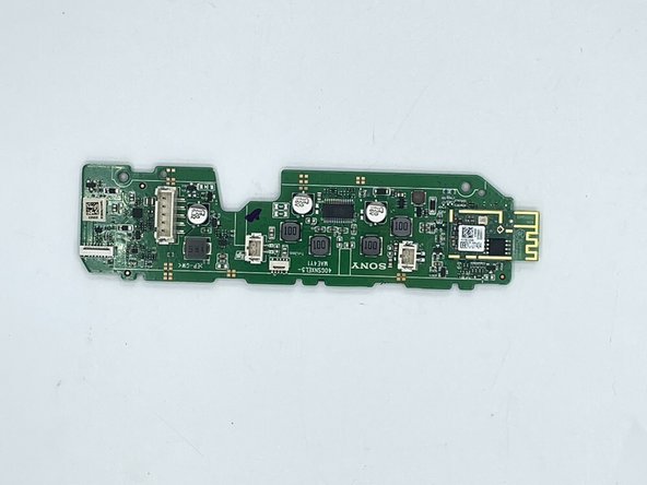

    • Remove the five 1 mm screws connecting the motherboard to the case with a Phillips #1 screwdriver.
    • Separate the motherboard from the case.
