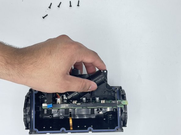

    • Remove the eight 1 mm screws that connect the motherboard case and the speaker case with a Phillips #1 screwdriver.
    • Remove the four 0.8 mm screws that connect the motherboard case and the speaker case with a Phillips #1 screwdriver.

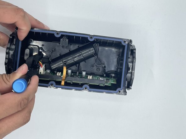

  4. Sony SRS-XE200 Charging Port Replacement: crwdns2935265:04crwdnd2935265:01crwdnd2935265:02crwdne2935265:0 Sony SRS-XE200 Charging Port Replacement: crwdns2935265:04crwdnd2935265:02crwdnd2935265:02crwdne2935265:0
    • Unplug the colored wires from the motherboard to detach the speaker assembly.

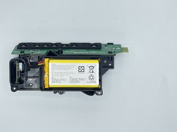

  5. Sony SRS-XE200 Charging Port Replacement, Battery: crwdns2935265:05crwdnd2935265:01crwdnd2935265:03crwdne2935265:0 Sony SRS-XE200 Charging Port Replacement, Battery: crwdns2935265:05crwdnd2935265:02crwdnd2935265:03crwdne2935265:0 Sony SRS-XE200 Charging Port Replacement, Battery: crwdns2935265:05crwdnd2935265:03crwdnd2935265:03crwdne2935265:0
    • Remove the five 1 mm screws connecting the motherboard to the case with a Phillips #1 screwdriver.
    • Separate the motherboard from the case.

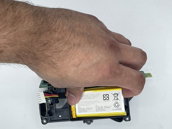

  6. Sony SRS-XE200 Charging Port Replacement: crwdns2935265:06crwdnd2935265:01crwdnd2935265:03crwdne2935265:0 Sony SRS-XE200 Charging Port Replacement: crwdns2935265:06crwdnd2935265:02crwdnd2935265:03crwdne2935265:0 Sony SRS-XE200 Charging Port Replacement: crwdns2935265:06crwdnd2935265:03crwdnd2935265:03crwdne2935265:0
    • Remove the battery from the battery holder with a nylon spudger.
    • Unplug the battery from the motherboard.
  7. Sony SRS-XE200 Charging Port Replacement, Charging Port: crwdns2935265:07crwdnd2935265:01crwdnd2935265:02crwdne2935265:0 Sony SRS-XE200 Charging Port Replacement, Charging Port: crwdns2935265:07crwdnd2935265:02crwdnd2935265:02crwdne2935265:0
    • Remove the charging port.
