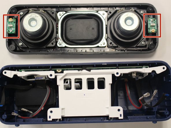

  8. Sony SRS-XB40 LED Control Panel Replacement, LED Control Panel: crwdns2935265:08crwdnd2935265:01crwdnd2935265:02crwdne2935265:0 Sony SRS-XB40 LED Control Panel Replacement, LED Control Panel: crwdns2935265:08crwdnd2935265:02crwdnd2935265:02crwdne2935265:0
    • After you take the speaker plate off the body of the speaker, locate the LED control panels on each end of the speaker plate.
  9. Sony SRS-XB40 LED Control Panel Replacement: crwdns2935265:09crwdnd2935265:01crwdnd2935265:01crwdne2935265:0
    • Unscrew the 10mm PH1 screw from each control panel.
    • The green panel should now be loose and connected only by the red and black plug in.
  10. Sony SRS-XB40 LED Control Panel Replacement: crwdns2935265:010crwdnd2935265:01crwdnd2935265:01crwdne2935265:0
    • Carefully unplug the wire from the panel, releasing the panel from the speaker plate.
  11. Sony SRS-XB40 LED Control Panel Replacement: crwdns2935265:011crwdnd2935265:01crwdnd2935265:01crwdne2935265:0
    • Your LED light control panel is now disassembled and ready to replace.
