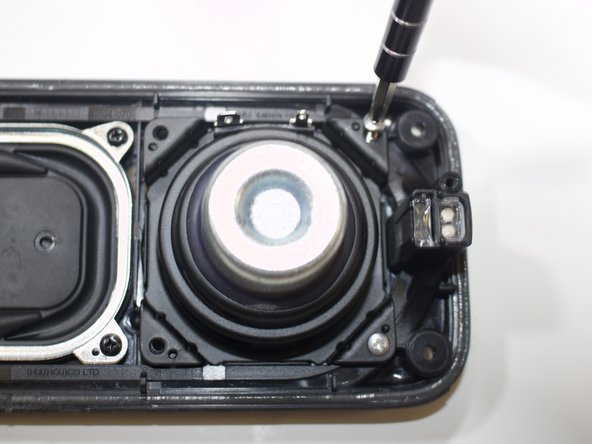

  17. Sony SRS-XB30 Speakers Replacement, Speakers: crwdns2935265:017crwdnd2935265:01crwdnd2935265:03crwdne2935265:0 Sony SRS-XB30 Speakers Replacement, Speakers: crwdns2935265:017crwdnd2935265:02crwdnd2935265:03crwdne2935265:0 Sony SRS-XB30 Speakers Replacement, Speakers: crwdns2935265:017crwdnd2935265:03crwdnd2935265:03crwdne2935265:0
    • Locate two silver screws (9mm) attached to each speaker shield.
    • Remove the two silver screws on each speaker shield using the screwdriver with the PH1 head.
  18. Sony SRS-XB30 Speakers Replacement: crwdns2935265:018crwdnd2935265:01crwdnd2935265:02crwdne2935265:0 Sony SRS-XB30 Speakers Replacement: crwdns2935265:018crwdnd2935265:02crwdnd2935265:02crwdne2935265:0
    • Remove the two individual speakers.
