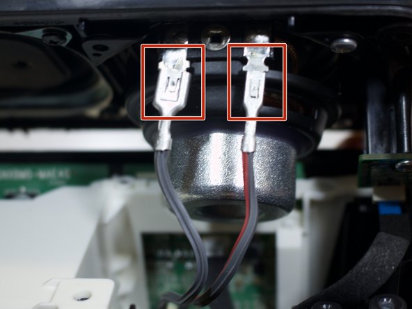

  6. Sony SRS-XB30 Charging Port Replacement: crwdns2935265:06crwdnd2935265:01crwdnd2935265:03crwdne2935265:0 Sony SRS-XB30 Charging Port Replacement: crwdns2935265:06crwdnd2935265:02crwdnd2935265:03crwdne2935265:0 Sony SRS-XB30 Charging Port Replacement: crwdns2935265:06crwdnd2935265:03crwdnd2935265:03crwdne2935265:0
    • Unclip the four wire connectors (that are attached to the speaker lid).
    • Disconnect the thin yellow wire (attached to the speaker lid) from its port.
  7. Sony SRS-XB30 Charging Port Replacement: crwdns2935265:07crwdnd2935265:01crwdnd2935265:01crwdne2935265:0
