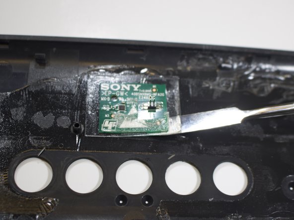

  17. Sony SRS-XB30 Bluetooth Chip Replacement, Bluetooth Chip: crwdns2935265:017crwdnd2935265:01crwdnd2935265:01crwdne2935265:0
    • To save time, pry up and remove the top panel first.
  18. Sony SRS-XB30 Bluetooth Chip Replacement: crwdns2935265:018crwdnd2935265:01crwdnd2935265:02crwdne2935265:0 Sony SRS-XB30 Bluetooth Chip Replacement: crwdns2935265:018crwdnd2935265:02crwdnd2935265:02crwdne2935265:0
    • Take the spudger and pry under the plastic square that the Bluetooth chip is directly attached to.
    • This will separate the plastic square from the lid.
  19. Sony SRS-XB30 Bluetooth Chip Replacement: crwdns2935265:019crwdnd2935265:01crwdnd2935265:01crwdne2935265:0
    • Remove the Bluetooth chip.

I'm pretty sure this is the nfc chip and not the Bluetooth chip
