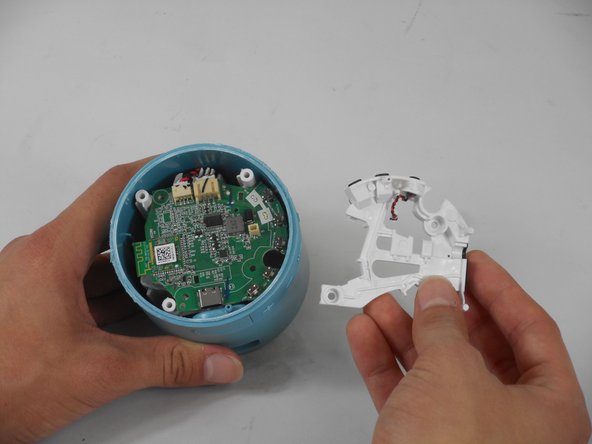

  4. Sony SRS-XB13 Speaker Replacement: crwdns2935265:04crwdnd2935265:01crwdnd2935265:03crwdne2935265:0 Sony SRS-XB13 Speaker Replacement: crwdns2935265:04crwdnd2935265:02crwdnd2935265:03crwdne2935265:0 Sony SRS-XB13 Speaker Replacement: crwdns2935265:04crwdnd2935265:03crwdnd2935265:03crwdne2935265:0
    • Place one end of the ifixit opening tool underneath the white bracket that sits above the motherboard, so that it latches onto the bottom side of the bracket.
    • With the opposite end of the tool, apply a gentle but firm downward motion to slowly pry the bracket from its position.
    • The microphone is embedded within the white bracket, so to replace the microphone, you must replace the bracket.
    • Once enough separation has occurred between the bracket and the motherboard, you can use your fingers to finish fully prying the bracket from its position.
    • The bracket has multiple edges that can be latched onto with the opening tool. It is recommended to use the opening tool in a counterclockwise pattern around the bracket. This helps prevent damaging the bracket, and smoothly releases it from its position.

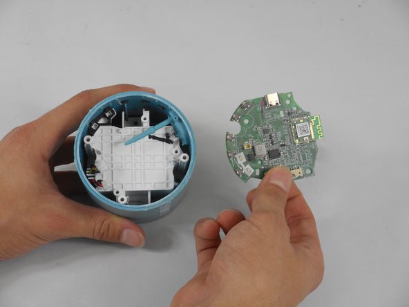

  5. Sony SRS-XB13 Speaker Replacement, Motherboard: crwdns2935265:05crwdnd2935265:01crwdnd2935265:03crwdne2935265:0 Sony SRS-XB13 Speaker Replacement, Motherboard: crwdns2935265:05crwdnd2935265:02crwdnd2935265:03crwdne2935265:0 Sony SRS-XB13 Speaker Replacement, Motherboard: crwdns2935265:05crwdnd2935265:03crwdnd2935265:03crwdne2935265:0
    • Using the precision tweezers set, pinch the tabs on the electric plugins and gently pull outwards to disconnect the wires from the motherboard.
    • Insert a finger under the motherboard and gently lift it out of the casing.
    • Make sure to be gentle when taking the motherboard out, as being too rough can cause damage to it.
