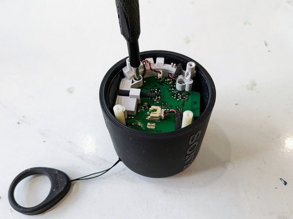

  3. Sony SRS-XB10 circuit board removal, Unscrew the board assembly: crwdns2935265:03crwdnd2935265:01crwdnd2935265:02crwdne2935265:0 Sony SRS-XB10 circuit board removal, Unscrew the board assembly: crwdns2935265:03crwdnd2935265:02crwdnd2935265:02crwdne2935265:0
    • Remove three 8mm Phillips #1 screws.

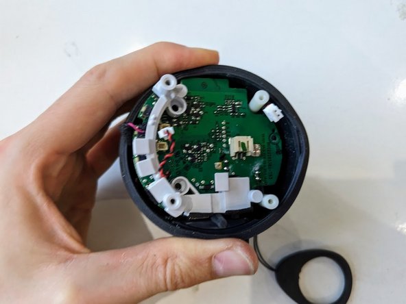

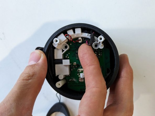

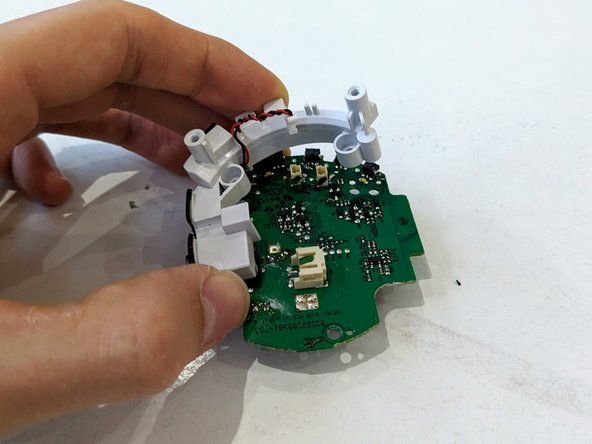

  5. Sony SRS-XB10 circuit board removal, Lift out the board assembly: crwdns2935265:05crwdnd2935265:01crwdnd2935265:02crwdne2935265:0 Sony SRS-XB10 circuit board removal, Lift out the board assembly: crwdns2935265:05crwdnd2935265:02crwdnd2935265:02crwdne2935265:0
    • The circuit board is very tightly fitted inside the casing. The easiest way to remove it is to squeeze between the white plastic cylinders attached to the circuit board and the opposite side of the casing (as shown in the first picture). This will allow you to start angling the board.
    • As the board starts to lift out, it can catch on the inside of the casing. At this point, it can be helpful to squeeze the casing, with your thumb next to the ports (see second picture), to free the board.
    • On the underside of the board is a fourth plug, so when the board does come loose try not to pull it away too quickly to avoid damaging that cable.

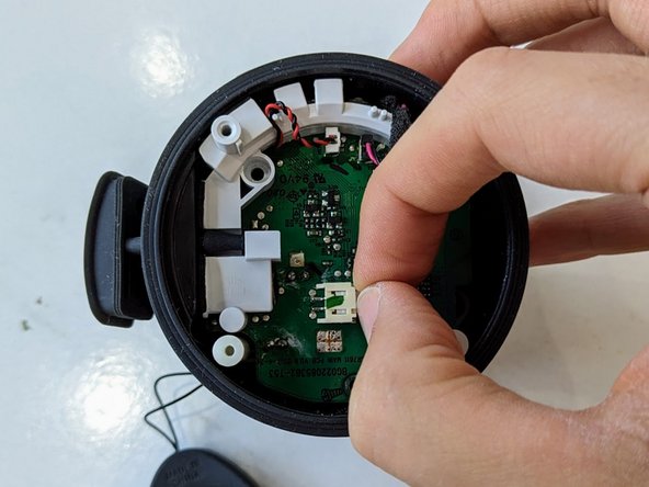

  6. Sony SRS-XB10 circuit board removal, Unplug the underside cable: crwdns2935265:06crwdnd2935265:01crwdnd2935265:01crwdne2935265:0
    • Disconnect the cable plugged in to the underside of the board.

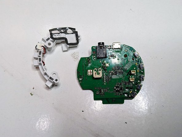

  7. Sony SRS-XB10 circuit board removal, Remove the plastic component cover: crwdns2935265:07crwdnd2935265:01crwdnd2935265:03crwdne2935265:0 Sony SRS-XB10 circuit board removal, Remove the plastic component cover: crwdns2935265:07crwdnd2935265:02crwdnd2935265:03crwdne2935265:0 Sony SRS-XB10 circuit board removal, Remove the plastic component cover: crwdns2935265:07crwdnd2935265:03crwdnd2935265:03crwdne2935265:0
    • Undo the two 8mm Phillips #1 screws on the underside of the circuit board.
    • Lift the white plastic component cover off the circuit board.
    • The USB and audio ports are surrounded by a black sticky-back layer. Peel this layer off carefully, as you'll want to stick it back down in one piece when reassembling.
