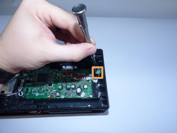

  6. Sony SRS-X7 Bluetooth Chip Replacement, Bluetooth Chip: crwdns2935265:06crwdnd2935265:01crwdnd2935265:02crwdne2935265:0 Sony SRS-X7 Bluetooth Chip Replacement, Bluetooth Chip: crwdns2935265:06crwdnd2935265:02crwdnd2935265:02crwdne2935265:0
    • Using your fingers, lightly pull on the white connector shown in the photo.
    • Unscrew the 10mm Philips J1 Screw from the guard above the bluetooth chip.
  7. Sony SRS-X7 Bluetooth Chip Replacement: crwdns2935265:07crwdnd2935265:01crwdnd2935265:02crwdne2935265:0 Sony SRS-X7 Bluetooth Chip Replacement: crwdns2935265:07crwdnd2935265:02crwdnd2935265:02crwdne2935265:0
    • Remove the bluetooth chip from the inside of the device.
    • Plug the new bluetooth chip into the motherboard and reassemble the device,
