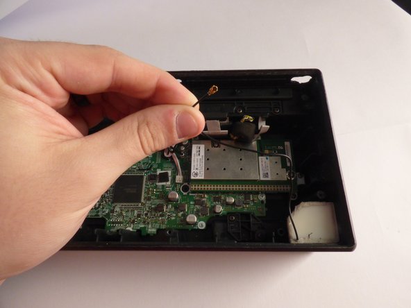

  6. Sony SRS-X7 AM/FM Chip Replacement, AM/FM Chip: crwdns2935265:06crwdnd2935265:01crwdnd2935265:02crwdne2935265:0 Sony SRS-X7 AM/FM Chip Replacement, AM/FM Chip: crwdns2935265:06crwdnd2935265:02crwdnd2935265:02crwdne2935265:0
    • Using your fingers, unplug the gold connector from the AM/FM chip.

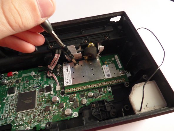

  7. Sony SRS-X7 AM/FM Chip Replacement: crwdns2935265:07crwdnd2935265:01crwdnd2935265:02crwdne2935265:0 Sony SRS-X7 AM/FM Chip Replacement: crwdns2935265:07crwdnd2935265:02crwdnd2935265:02crwdne2935265:0
    • Remove the two Philips J1 10mm screws from the top side and right side of the AM/FM chip.

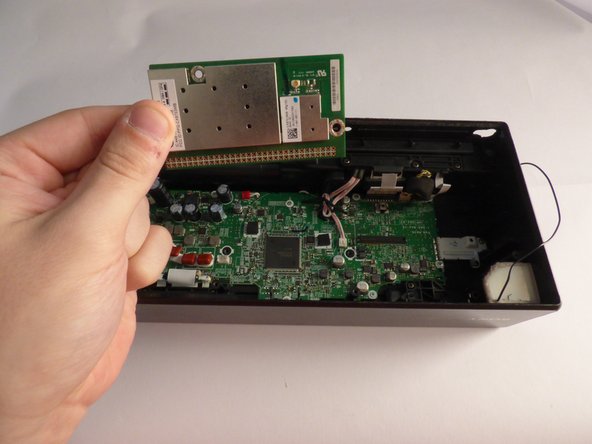

  8. Sony SRS-X7 AM/FM Chip Replacement: crwdns2935265:08crwdnd2935265:01crwdnd2935265:02crwdne2935265:0 Sony SRS-X7 AM/FM Chip Replacement: crwdns2935265:08crwdnd2935265:02crwdnd2935265:02crwdne2935265:0
    • Gently with your fingers, or a plastic grasping tool, remove the chip from the unit.

AM-FM Chip ?? Bad Translation ?
This Model has no Radio Funktion
This is the WIFI Circuit for Wireless Communication
