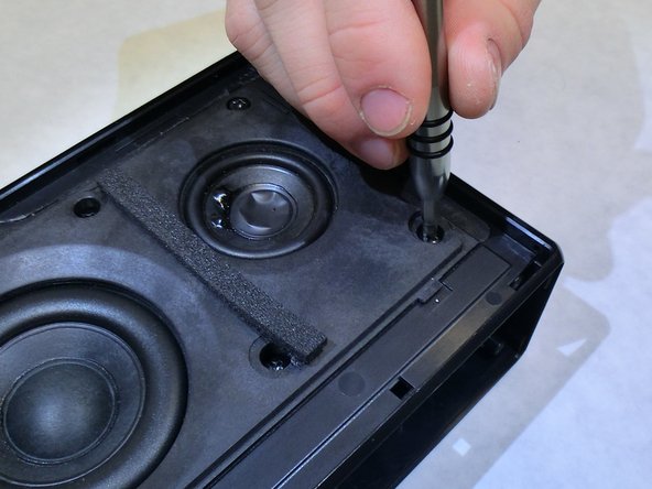

    • Locate the six 9 mm screws on the bottom of the speaker and remove them using Phillips head #2.

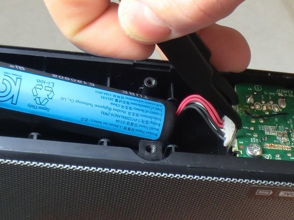

    • Locate the battery connection and unplug it using a pair of metal tweezers.

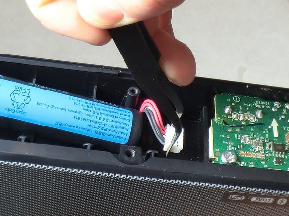

    • Locate the remaining two 3.5 mm screws on the bottom of the I/O board and remove them using a Phillips head #2 screwdriver.
  5. Sony SRS-X55 Speaker Reverberator Replacement: crwdns2935265:05crwdnd2935265:01crwdnd2935265:01crwdne2935265:0
    • Remove the I/O board from the rest of the speaker. A plastic spudger can aid in this process if it is inserted into the edge as shown and gently pried.

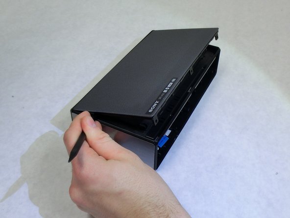

  6. Sony SRS-X55 Speaker Reverberator Replacement: crwdns2935265:06crwdnd2935265:01crwdnd2935265:02crwdne2935265:0 Sony SRS-X55 Speaker Reverberator Replacement: crwdns2935265:06crwdnd2935265:02crwdnd2935265:02crwdne2935265:0

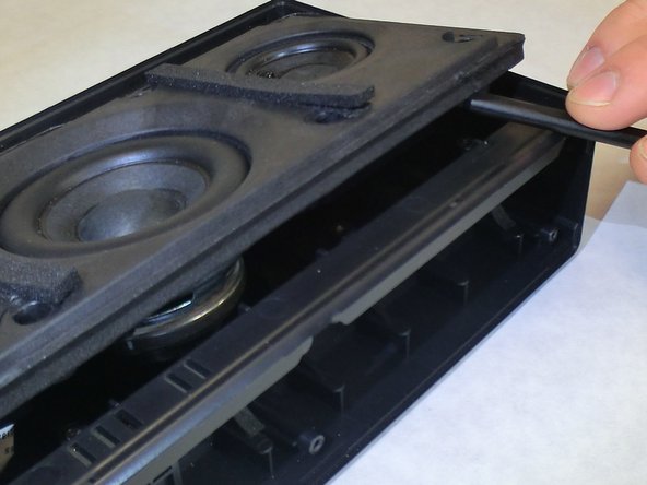

    • Insert a plastic spudger into the seam where the forward facing metal speaker cover meets the speaker body and gently pry it upward until it releases.

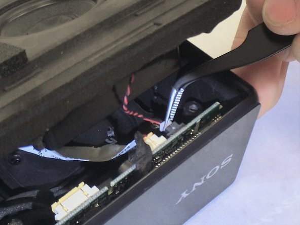

  9. Sony SRS-X55 Speaker Reverberator Replacement: crwdns2935265:09crwdnd2935265:01crwdnd2935265:03crwdne2935265:0 Sony SRS-X55 Speaker Reverberator Replacement: crwdns2935265:09crwdnd2935265:02crwdnd2935265:03crwdne2935265:0 Sony SRS-X55 Speaker Reverberator Replacement: crwdns2935265:09crwdnd2935265:03crwdnd2935265:03crwdne2935265:0
    • Locate the two wire connections as shown underneath of the speaker assembly and unplug them using a pair of tweezers.
    • Lift the speaker assembly away.

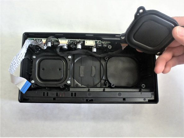

    • Locate the eight 7.5 mm screws across both of the speaker reverberators and remove them using a Phillips head #2 screwdriver.
    • Lift the speaker reverberators away and replace them.
