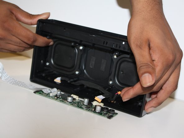

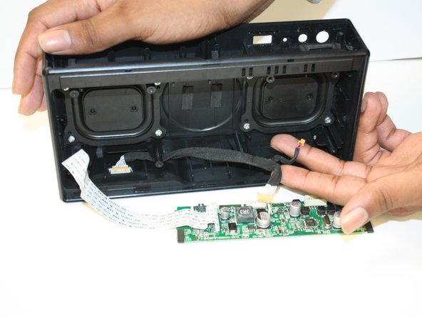

  5. Sony SRS-X55 Motherboard Replacement, Motherboard: crwdns2935265:05crwdnd2935265:01crwdnd2935265:03crwdne2935265:0 Sony SRS-X55 Motherboard Replacement, Motherboard: crwdns2935265:05crwdnd2935265:02crwdnd2935265:03crwdne2935265:0 Sony SRS-X55 Motherboard Replacement, Motherboard: crwdns2935265:05crwdnd2935265:03crwdnd2935265:03crwdne2935265:0
    • Flip open the speaker panel to access the interior of the device.
    • Carefully unplug the three cables and one ribbon connector connected to the motherboard.
    • Remove the motherboard.
