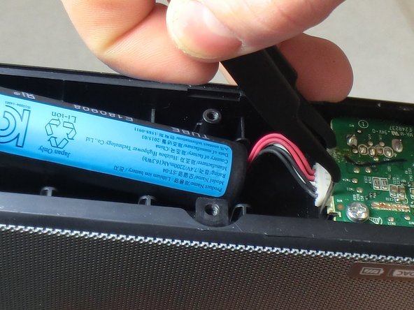

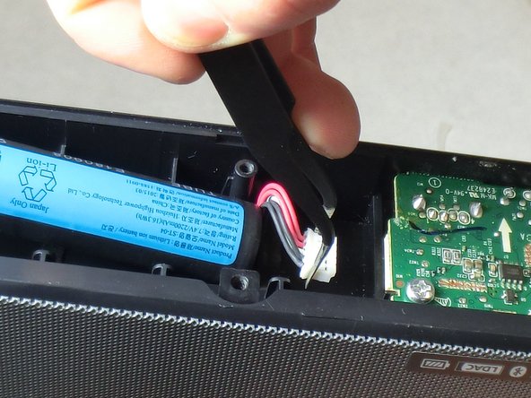

    • Locate the battery plug and remove it using a pair of tweezers.

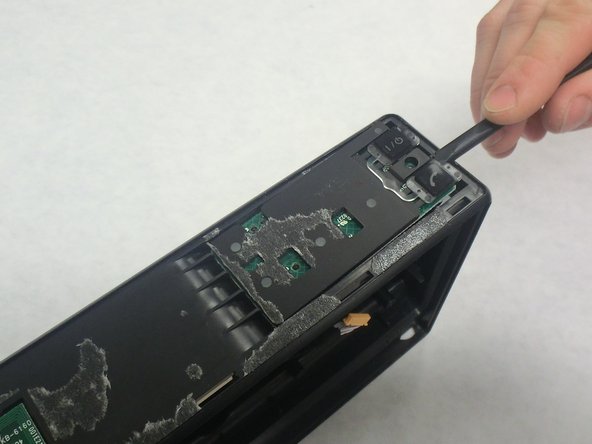

  4. Sony SRS-X55 Input Board Replacement: crwdns2935265:04crwdnd2935265:01crwdnd2935265:03crwdne2935265:0 Sony SRS-X55 Input Board Replacement: crwdns2935265:04crwdnd2935265:02crwdnd2935265:03crwdne2935265:0 Sony SRS-X55 Input Board Replacement: crwdns2935265:04crwdnd2935265:03crwdnd2935265:03crwdne2935265:0
    • Locate the two 3.5 mm screws on the bottom of the I/O board and remove them using a Phillips head #2 screwdriver.
  5. Sony SRS-X55 Input Board Replacement: crwdns2935265:05crwdnd2935265:01crwdnd2935265:01crwdne2935265:0
    • Use a plastic spudger to remove the I/O board from the speaker body.

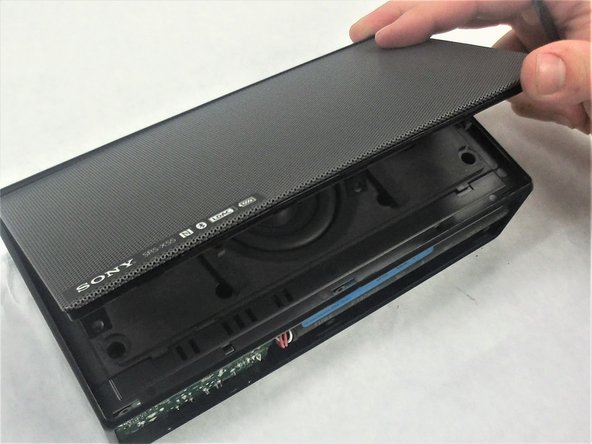

  6. Sony SRS-X55 Input Board Replacement: crwdns2935265:06crwdnd2935265:01crwdnd2935265:02crwdne2935265:0 Sony SRS-X55 Input Board Replacement: crwdns2935265:06crwdnd2935265:02crwdnd2935265:02crwdne2935265:0
    • Insert a plastic spudger into the seam of the metal speaker cover and pry it downward until it releases from the speaker body.

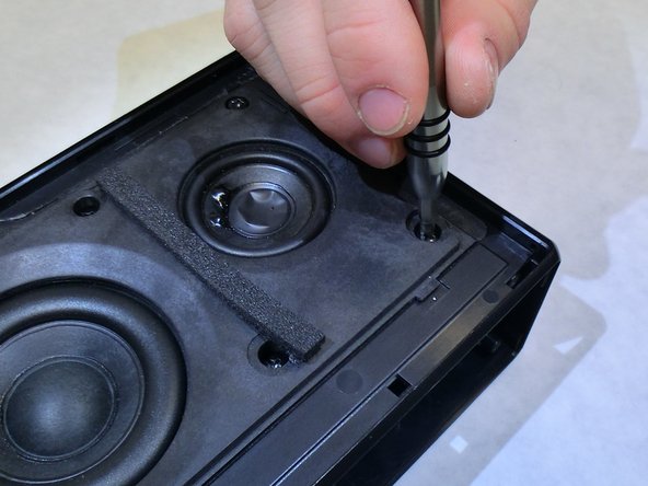

  7. Sony SRS-X55 Input Board Replacement: crwdns2935265:07crwdnd2935265:01crwdnd2935265:02crwdne2935265:0 Sony SRS-X55 Input Board Replacement: crwdns2935265:07crwdnd2935265:02crwdnd2935265:02crwdne2935265:0
    • Locate the eight 8.9 mm screws on the face of the speaker assembly and remove them using a Phillips head #2 screwdriver.
  8. Sony SRS-X55 Input Board Replacement: crwdns2935265:08crwdnd2935265:01crwdnd2935265:02crwdne2935265:0 Sony SRS-X55 Input Board Replacement: crwdns2935265:08crwdnd2935265:02crwdnd2935265:02crwdne2935265:0
    • Insert a plastic spudger underneath one of the tabs located on the front of the speaker assembly and gently raise the speaker assembly above the rest of the speaker.
    • Continue to the next step before attempting to lift the speaker assembly from the rest of the speaker entirely to avoid damaging internal wires.

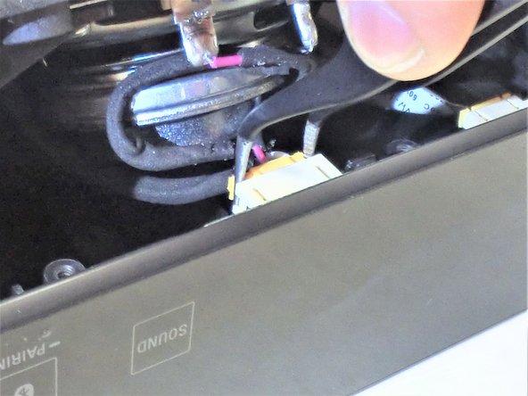

  9. Sony SRS-X55 Input Board Replacement: crwdns2935265:09crwdnd2935265:01crwdnd2935265:03crwdne2935265:0 Sony SRS-X55 Input Board Replacement: crwdns2935265:09crwdnd2935265:02crwdnd2935265:03crwdne2935265:0 Sony SRS-X55 Input Board Replacement: crwdns2935265:09crwdnd2935265:03crwdnd2935265:03crwdne2935265:0
    • Locate the two wire connections as shown underneath of the speaker assembly and unplug them using a pair of tweezers.

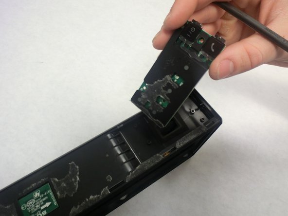

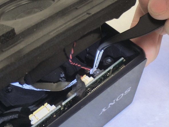

  10. Sony SRS-X55 Input Board Replacement: crwdns2935265:010crwdnd2935265:01crwdnd2935265:01crwdne2935265:0
    • Locate the wire connecting the motherboard and the input board under the top panel of the speaker and remove it using a pair of tweezers.

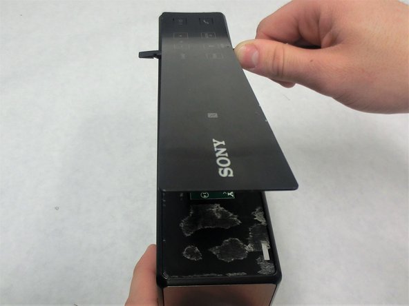

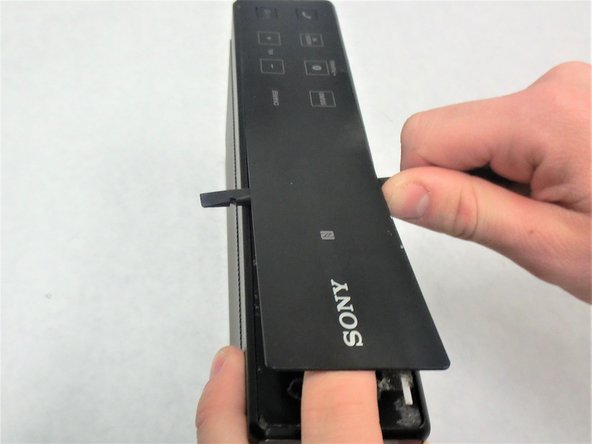

  11. Sony SRS-X55 Input Board Replacement: crwdns2935265:011crwdnd2935265:01crwdnd2935265:03crwdne2935265:0 Sony SRS-X55 Input Board Replacement: crwdns2935265:011crwdnd2935265:02crwdnd2935265:03crwdne2935265:0 Sony SRS-X55 Input Board Replacement: crwdns2935265:011crwdnd2935265:03crwdnd2935265:03crwdne2935265:0
    • Insert a plastic spudger into the seam at the edge of the top panel and gently pry it away from the rest of the speaker.
    • The spudger can be inserted laterally into the opening created by the spudger and slid along the top as shown to remove the panel in a single motion.

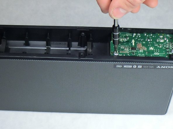

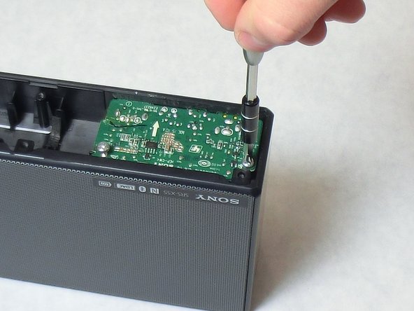

  12. Sony SRS-X55 Input Board Replacement: crwdns2935265:012crwdnd2935265:01crwdnd2935265:01crwdne2935265:0
    • Locate the three 4.5 mm screws on top of the speaker input board and remove them using a Phillips head #2 screwdriver.
  13. Sony SRS-X55 Input Board Replacement: crwdns2935265:013crwdnd2935265:01crwdnd2935265:03crwdne2935265:0 Sony SRS-X55 Input Board Replacement: crwdns2935265:013crwdnd2935265:02crwdnd2935265:03crwdne2935265:0 Sony SRS-X55 Input Board Replacement: crwdns2935265:013crwdnd2935265:03crwdnd2935265:03crwdne2935265:0
    • Insert a plastic spudger underneath the edge of the input board and gently pry it away from the rest of the speaker.
