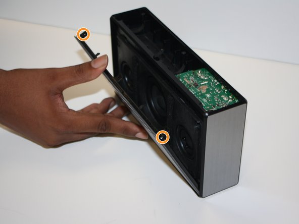

  3. Sony SRS-X55 I/O Board Replacement, I/O Board: crwdns2935265:03crwdnd2935265:01crwdnd2935265:02crwdne2935265:0 Sony SRS-X55 I/O Board Replacement, I/O Board: crwdns2935265:03crwdnd2935265:02crwdnd2935265:02crwdne2935265:0
    • Remove the two Phillips screws from the I/O board.
    • Remove the front panel to the speaker by pushing on the two tabs in the corners.
  4. Sony SRS-X55 I/O Board Replacement: crwdns2935265:04crwdnd2935265:01crwdnd2935265:01crwdne2935265:0
    • Disconnect the ribbon cable from the I/O board.
    • Carefully remove the I/O board from the speaker.
