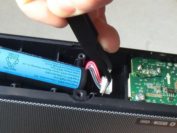

    • Unplug the wiring connecting the battery to the IO board using the tweezers, then remove the battery.

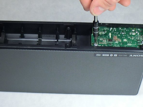

    • Remove the 3.5 mm silver screws on top of the I/O board using Phillips head #2 screw driver.

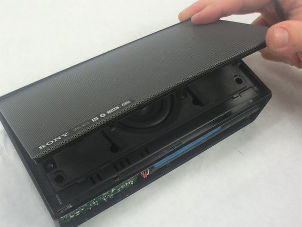

    • Insert the plastic sudger into the seam where the metal speaker cover meets the speaker body. Slide the sudger along the edge to detach the two components and set aside the cover.

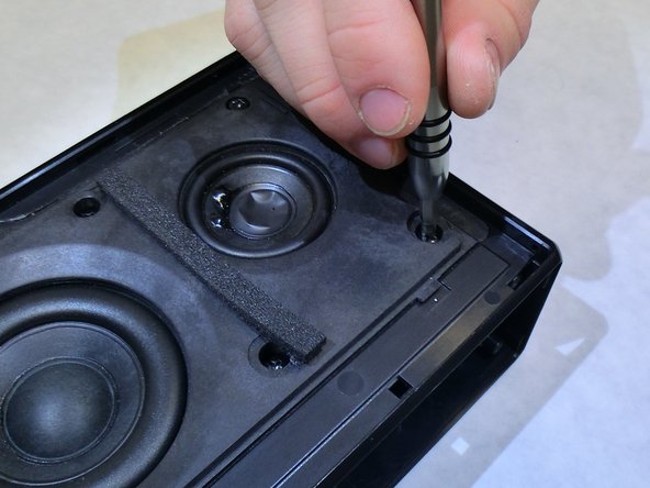

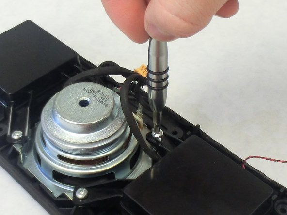

    • Remove the 8.9 mm screws holding the speaker assembly to the speaker body using Phillips head #2 screw driver.

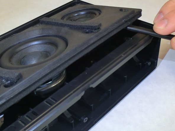

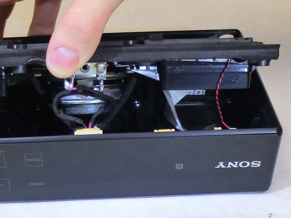

    • Place the plastic spudger under one of the tabs on the face of the speaker assembly and gently lift it from the speaker body.
    • Wires connect the speaker assembly to the inside of the speaker body. Move on to the next step before lifting speakers entirely from body to avoid damaging wires.

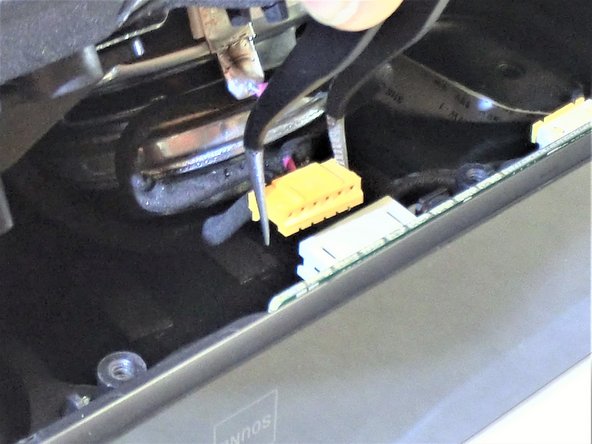

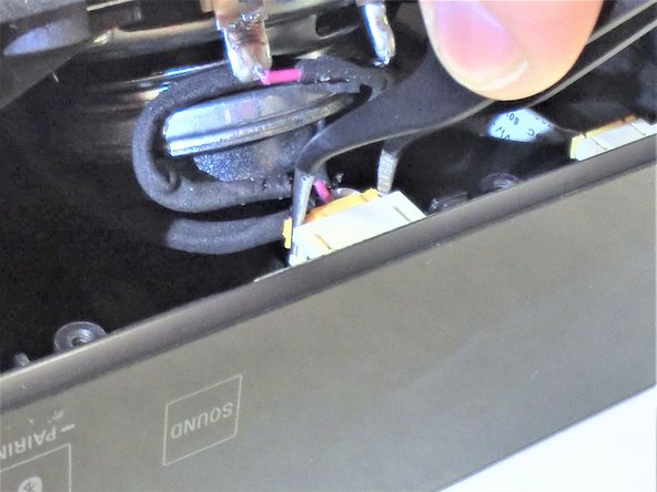

    • Use the tweezers to disconnect the two cables from the input board and motherboard and finish lifting the speaker assembly from the speaker body.

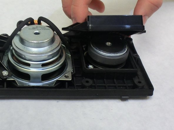

    • Remove the 9 mm screws on the back of the speaker assembly using Phillips head #2 screw driver.
    • Lift both speaker covers from the speaker assembly.

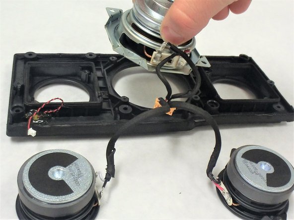

    • Gently lift the auxiliary speakers from the speaker assembly.
    • CAUTION: Lift the auxiliary speakers slowly to prevent damaging the wires; they are held in place by a mild adhesive.
    • Lift the sub-woofer from the speaker assembly.

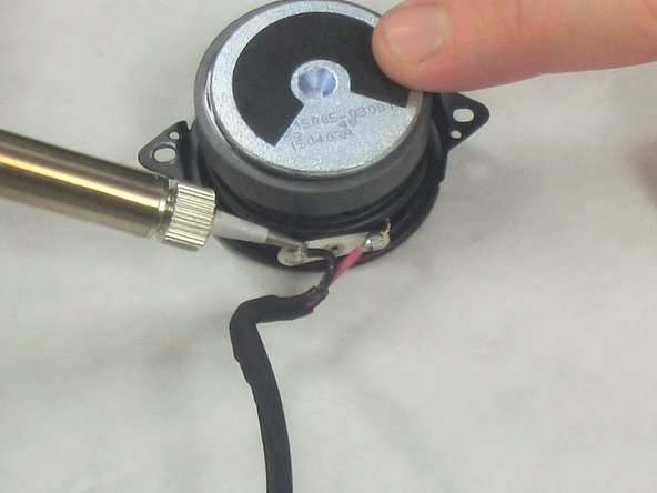

    • Place the tip of the soldering iron against the wire terminals until the connection separates on its own. The three terminal locations are shown.
    • Reconnect the leads to the proper terminals. Use either of the other speakers as a reference if needed; they will have the same wire configuration.
