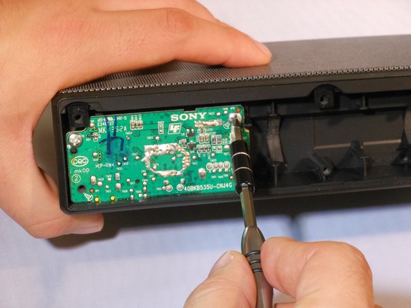

  11. Sony SRS-X5 USB/AUX plug in Replacement, USB/AUX plug in: crwdns2935265:011crwdnd2935265:01crwdnd2935265:02crwdne2935265:0 Sony SRS-X5 USB/AUX plug in Replacement, USB/AUX plug in: crwdns2935265:011crwdnd2935265:02crwdnd2935265:02crwdne2935265:0
    • Using the Phillips #1 screwdriver, remove the two 6mm screws holding the AUX board in place.
  12. Sony SRS-X5 USB/AUX plug in Replacement: crwdns2935265:012crwdnd2935265:01crwdnd2935265:01crwdne2935265:0
    • Remove the aux board. Be careful as the board might need some wiggling to get out.
