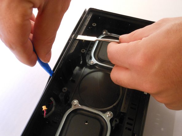

  9. Sony SRS-X5 Button Pad Replacement: crwdns2935265:09crwdnd2935265:01crwdnd2935265:02crwdne2935265:0 Sony SRS-X5 Button Pad Replacement: crwdns2935265:09crwdnd2935265:02crwdnd2935265:02crwdne2935265:0
    • Using both the plastic opening tool and metal spudger gently pry open the cover from the top of the speaker.
  10. Sony SRS-X5 Button Pad Replacement: crwdns2935265:010crwdnd2935265:01crwdnd2935265:01crwdne2935265:0
    • Gently remove the cover using your hands.
    • Make sure you remove the cover gently so it doesn't break.

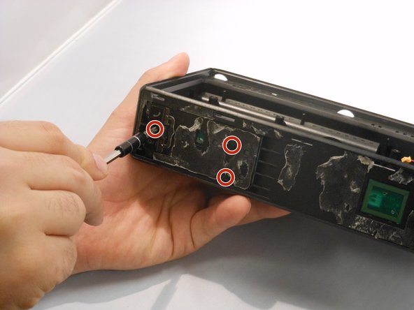

  11. Sony SRS-X5 Button Pad Replacement: crwdns2935265:011crwdnd2935265:01crwdnd2935265:02crwdne2935265:0 Sony SRS-X5 Button Pad Replacement: crwdns2935265:011crwdnd2935265:02crwdnd2935265:02crwdne2935265:0
    • Using the Phillips #00, unscrew the three 3.32mm screws keeping the button board in place.
  12. Sony SRS-X5 Button Pad Replacement: crwdns2935265:012crwdnd2935265:01crwdnd2935265:01crwdne2935265:0
    • Gently remove the button pad from the speaker.
