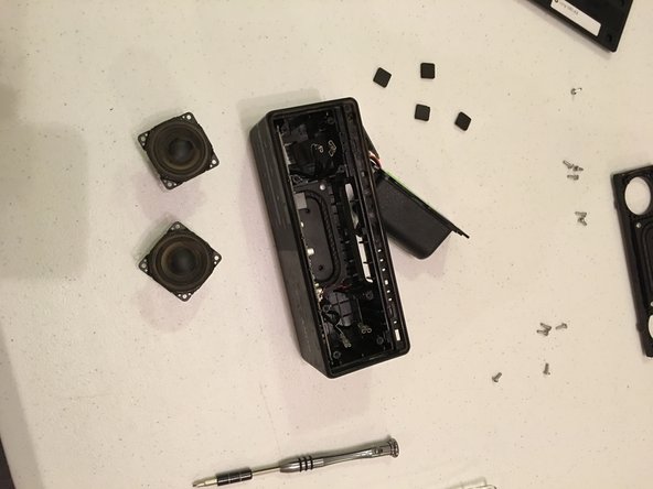

    • Remove the rubber feet on the bottom of the device.
  2. Sony SRS-X3 Speakers Replacement: crwdns2935265:02crwdnd2935265:01crwdnd2935265:01crwdne2935265:0
    • Remove the 6 silver screws with a Phillips #1 screwdriver.
    • Remove the bottom plastic cover of speaker.
  3. Sony SRS-X3 Speakers Replacement: crwdns2935265:03crwdnd2935265:01crwdnd2935265:01crwdne2935265:0
    • Remove the two screws holding the battery pack with the Phillips #1 screwdriver.
    • Remove the battery back with a spudger.
  4. Sony SRS-X3 Speakers Replacement: crwdns2935265:04crwdnd2935265:01crwdnd2935265:01crwdne2935265:0
    • Remove the three screws using a Phillips #1 screwdriver.
    • Remove the green circuit board and the battery pack.
    • The battery pack and green circuit board will still be connected to the speaker by a ribbon wire.
  5. Sony SRS-X3 Speakers Replacement: crwdns2935265:05crwdnd2935265:01crwdnd2935265:02crwdne2935265:0 Sony SRS-X3 Speakers Replacement: crwdns2935265:05crwdnd2935265:02crwdnd2935265:02crwdne2935265:0
    • Pop off the front speaker face (dark grey with little holes) by pushing out 3 tabs where screws were previously located and sticking the spudger in the crack where grey speaker face meets the outer shell.
    • You may really have to pry on this part; it is not easy to remove and will pop out when released.
  6. Sony SRS-X3 Speakers Replacement: crwdns2935265:06crwdnd2935265:01crwdnd2935265:01crwdne2935265:0
    • Remove the eight black screws with a Phillips #1 screwdriver.
  7. Sony SRS-X3 Speakers Replacement: crwdns2935265:07crwdnd2935265:01crwdnd2935265:02crwdne2935265:0 Sony SRS-X3 Speakers Replacement: crwdns2935265:07crwdnd2935265:02crwdnd2935265:02crwdne2935265:0
    • Remove the front face by prying the two black tabs using a spudger.
    • This face is glued in and may need some elbow grease to remove. Don't worry about breaking anything, as it is all connected.
  8. Sony SRS-X3 Speakers Replacement: crwdns2935265:08crwdnd2935265:01crwdnd2935265:02crwdne2935265:0 Sony SRS-X3 Speakers Replacement: crwdns2935265:08crwdnd2935265:02crwdnd2935265:02crwdne2935265:0
    • Remove the speaker wires from each speaker (2 wires per speaker) and take the speakers out of the device.
    • The speaker wire connectors are made to connect very snug, so they should be hard to remove. Give it a good tug and they should pop off the male end.
    • Remove the speakers from the device.

Where would I get the new speakers from tho? Thanks a lot
Ruben Götz - crwdns2934203:0crwdne2934203:0
Where I can buy one speaker as a spare part?
Karim Karimov - crwdns2934203:0crwdne2934203:0
I would also like to know where I can get a replacement speaker
Aaron Todd - crwdns2934203:0crwdne2934203:0
This SRS X3 cannot be used with the dc in 5v plugged, how can i do to make it work continuously with the charge cable? It have to be hacked? thanks
carlos cesar quan - crwdns2934203:0crwdne2934203:0
It requires 8.4v, so 5v isn't enough to charge and have powered on... Get a 8.4v charger and wire it to the battery connector.
