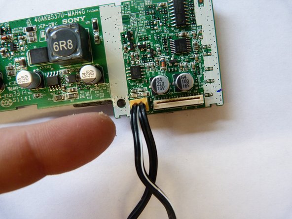

  9. Sony SRS-X3 Motherboard Replacement, Motherboard: crwdns2935265:09crwdnd2935265:01crwdnd2935265:03crwdne2935265:0 Sony SRS-X3 Motherboard Replacement, Motherboard: crwdns2935265:09crwdnd2935265:02crwdnd2935265:03crwdne2935265:0 Sony SRS-X3 Motherboard Replacement, Motherboard: crwdns2935265:09crwdnd2935265:03crwdnd2935265:03crwdne2935265:0
    • Remove the ribbon wire simply by pulling it out of the fixture in which it connects. Once removed, sit the small green board to the side and prepare to remove the Motherboard.

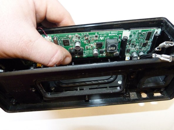

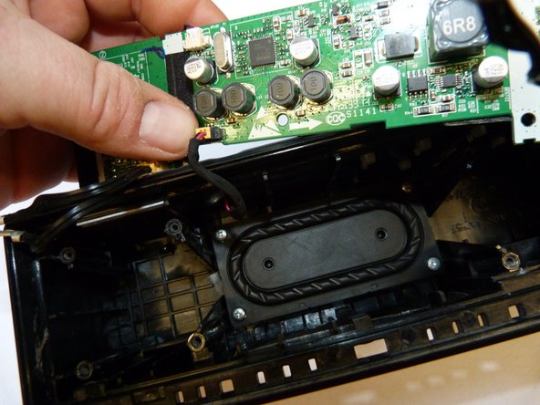

  10. Sony SRS-X3 Motherboard Replacement: crwdns2935265:010crwdnd2935265:01crwdnd2935265:02crwdne2935265:0 Sony SRS-X3 Motherboard Replacement: crwdns2935265:010crwdnd2935265:02crwdnd2935265:02crwdne2935265:0
    • Locate the Motherboard through the hole in which the battery pack normally rests.
    • Use your fingers to pull the board upwards while the speakers top is facing downwards. In doing so, use more force than you are comfortable with. (Do NOT worry. The board slides upwards, regardless of the friction that may seem like it is keeping it from sliding out.)

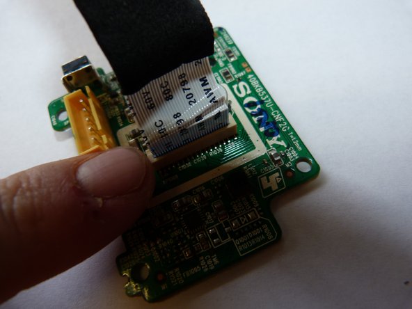

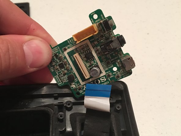

  11. Sony SRS-X3 Motherboard Replacement: crwdns2935265:011crwdnd2935265:01crwdnd2935265:03crwdne2935265:0 Sony SRS-X3 Motherboard Replacement: crwdns2935265:011crwdnd2935265:02crwdnd2935265:03crwdne2935265:0 Sony SRS-X3 Motherboard Replacement: crwdns2935265:011crwdnd2935265:03crwdnd2935265:03crwdne2935265:0
    • Once the Motherboard has been removed, you are free to remove all of the wires that are connected to it. Gently pull on the clips where the wires insert into the board to remove all of the wires.
