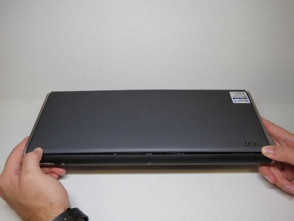

    • Locate the four rubber grips on the bottom of the speaker. Use the plastic opening tool to remove the grips, exposing the underlying screws.
  2. Sony SRS-BTX500 Speaker Replacement: crwdns2935265:02crwdnd2935265:01crwdnd2935265:02crwdne2935265:0 Sony SRS-BTX500 Speaker Replacement: crwdns2935265:02crwdnd2935265:02crwdnd2935265:02crwdne2935265:0
    • Using a Phillips #1 screwdriver, remove the four 5mm screws that were underneath the four rubber grips.

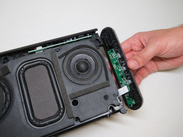

    • With the front of the speaker facing you, run the plastic opening tool along the bottom of the speaker. Then push the face of the speaker at both ends before lifting it off.

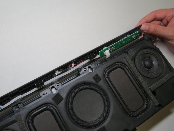

    • Lift off the casing on the left, right, and top of the speaker.

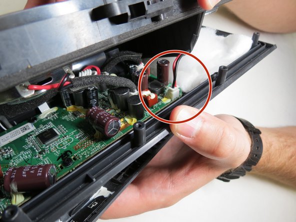

  8. Sony SRS-BTX500 Speaker Replacement: crwdns2935265:08crwdnd2935265:01crwdnd2935265:03crwdne2935265:0 Sony SRS-BTX500 Speaker Replacement: crwdns2935265:08crwdnd2935265:02crwdnd2935265:03crwdne2935265:0 Sony SRS-BTX500 Speaker Replacement: crwdns2935265:08crwdnd2935265:03crwdnd2935265:03crwdne2935265:0

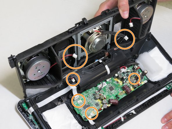

    • Pull apart the speaker from the top. Unplug the indicated exposed wire that connects the speakers and the motherboard.
    • After the first wire is disconnected, separate the other connecting wires.

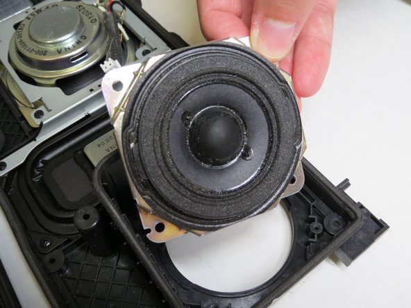

  9. Sony SRS-BTX500 Speaker Replacement, Speaker: crwdns2935265:09crwdnd2935265:01crwdnd2935265:03crwdne2935265:0 Sony SRS-BTX500 Speaker Replacement, Speaker: crwdns2935265:09crwdnd2935265:02crwdnd2935265:03crwdne2935265:0 Sony SRS-BTX500 Speaker Replacement, Speaker: crwdns2935265:09crwdnd2935265:03crwdnd2935265:03crwdne2935265:0

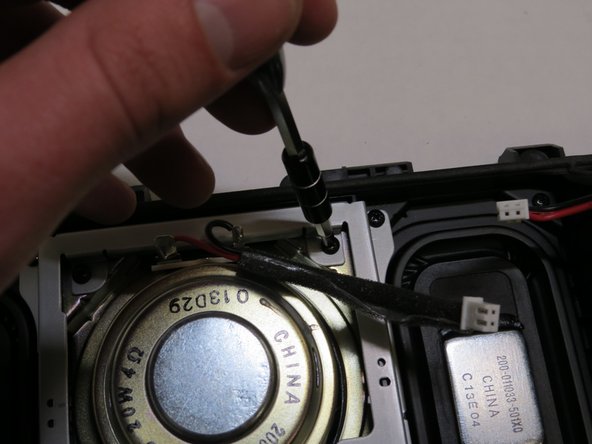

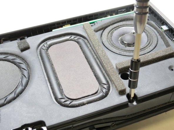

    • Locate the broken speaker, and using a Philips #1 screwdriver, remove the four 7 mm screws to release the speaker from its position.
    • If replacing the center speaker, four additional 7 mm screws must be removed as indicated.
    • Replace it with the new speaker you have in your possession.
