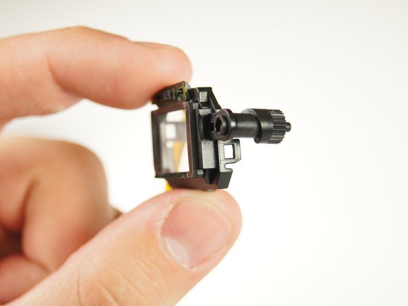

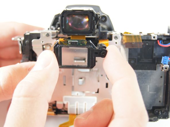

  13. Sony SLT Alpha-65V Viewfinder Replacement, Viewfinder: crwdns2935265:013crwdnd2935265:01crwdnd2935265:03crwdne2935265:0 Sony SLT Alpha-65V Viewfinder Replacement, Viewfinder: crwdns2935265:013crwdnd2935265:02crwdnd2935265:03crwdne2935265:0 Sony SLT Alpha-65V Viewfinder Replacement, Viewfinder: crwdns2935265:013crwdnd2935265:03crwdnd2935265:03crwdne2935265:0
    • The rotating dial on the right side of the eyepiece sensor is loosely connected and may fall out when removing the sensor.
    • Gently remove the eyepiece sensor from the viewfinder.
  14. Sony SLT Alpha-65V Viewfinder Replacement: crwdns2935265:014crwdnd2935265:01crwdnd2935265:02crwdne2935265:0 Sony SLT Alpha-65V Viewfinder Replacement: crwdns2935265:014crwdnd2935265:02crwdnd2935265:02crwdne2935265:0
    • The viewfinder will pop out of its slot.
    • Gently remove the viewfinder from the camera.
