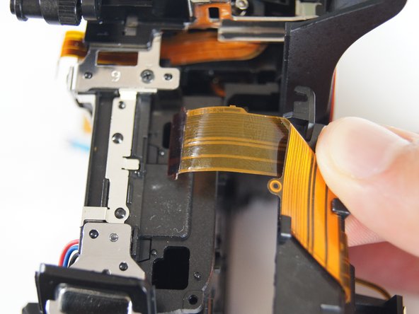

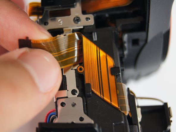

  15. Sony SLT Alpha-65V Flash Capacitor Replacement: crwdns2935265:015crwdnd2935265:01crwdnd2935265:03crwdne2935265:0 Sony SLT Alpha-65V Flash Capacitor Replacement: crwdns2935265:015crwdnd2935265:02crwdnd2935265:03crwdne2935265:0 Sony SLT Alpha-65V Flash Capacitor Replacement: crwdns2935265:015crwdnd2935265:03crwdnd2935265:03crwdne2935265:0
    • The small hole in the ribbon shown with the red square may get caught in the pin it goes around. Make sure to gently lift the ribbon from this point first before anywhere else.
    • Gently lift the circuit ribbon off the camera and maneuver the ribbon around the plastic bearings until it comes completely off.
    • The flash capacitor will be soldered into the part that detaches from the camera. This entire part will need to be replaced.
