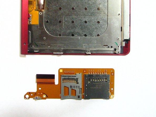

      • Lift the end of the motherboard closest to the memory cards and pull out.
    1. Sony Reader Touch Edition PRS-600 Screen Replacement, Screen: crwdns2935265:015crwdnd2935265:01crwdnd2935265:02crwdne2935265:0 Sony Reader Touch Edition PRS-600 Screen Replacement, Screen: crwdns2935265:015crwdnd2935265:02crwdnd2935265:02crwdne2935265:0
      • Using a Phillips head screwdriver, remove the three 1.4 mm screws located on the SD/memory card holder.
      • Remove the SD/memory card holder from the device.
