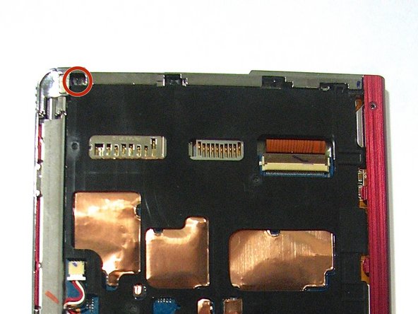

  7. Sony Reader Touch Edition PRS-600 Power Button Replacement: crwdns2935265:07crwdnd2935265:01crwdnd2935265:03crwdne2935265:0 Sony Reader Touch Edition PRS-600 Power Button Replacement: crwdns2935265:07crwdnd2935265:02crwdnd2935265:03crwdne2935265:0 Sony Reader Touch Edition PRS-600 Power Button Replacement: crwdns2935265:07crwdnd2935265:03crwdnd2935265:03crwdne2935265:0
    • Using the Phillips screwdriver remove the 1.4 mm screw from the top panel.
    • Using the same screwdriver, remove the 1.4 mm screw from the back of the device.
    • Pry apart off the top panel of the device.
