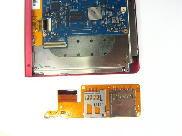

    1. Sony Reader Touch Edition PRS-600 Audio/Micro USB/AC Adapter Jacks  Replacement, SD and Pro Duo Memory Cards Holder: crwdns2935265:015crwdnd2935265:01crwdnd2935265:01crwdne2935265:0
      • Using a Phillips head screwdriver, remove the three 1.4 mm screws located on the memory card holder.
    2. Sony Reader Touch Edition PRS-600 Audio/Micro USB/AC Adapter Jacks  Replacement: crwdns2935265:016crwdnd2935265:01crwdnd2935265:01crwdne2935265:0
      • Using the flat end of the spudger, pry open the brown flap that connects the cardholder to the motherboard.
    3. Sony Reader Touch Edition PRS-600 Audio/Micro USB/AC Adapter Jacks  Replacement: crwdns2935265:017crwdnd2935265:01crwdnd2935265:02crwdne2935265:0 Sony Reader Touch Edition PRS-600 Audio/Micro USB/AC Adapter Jacks  Replacement: crwdns2935265:017crwdnd2935265:02crwdnd2935265:02crwdne2935265:0
      • Pull the orange strip out of the opened brown flap.
      • Remove the memory card holder.
