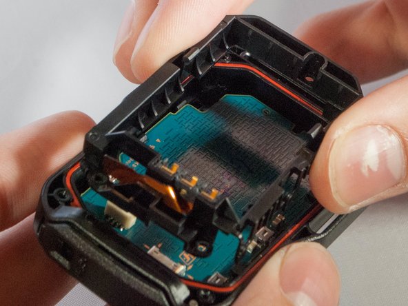

      • Unscrew the 3 (three) screws holding the bracket in place.
      • Then remove the bracket by prying one end up.
      • Do not rip the ribbon cable connecting the bracket to the motherboard.

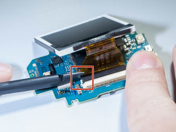

      • Undo the ribbon cable attached between the motherboard and screen by prying up black tab which holds the cable, using spudger. (See pictures)
    6. Sony RM-LVR1 LCD Screen Replacement: crwdns2935265:08crwdnd2935265:01crwdnd2935265:01crwdne2935265:0
      • Remove the screen from the motherboard.
