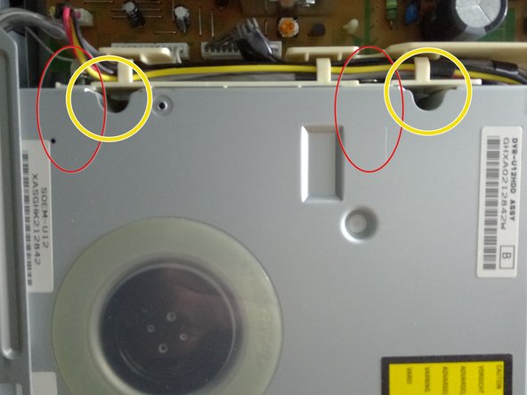

  3. Sony RDR HX750 HX950 Disassembly, Remove DVD player: crwdns2935265:03crwdnd2935265:01crwdnd2935265:03crwdne2935265:0 Sony RDR HX750 HX950 Disassembly, Remove DVD player: crwdns2935265:03crwdnd2935265:02crwdnd2935265:03crwdne2935265:0 Sony RDR HX750 HX950 Disassembly, Remove DVD player: crwdns2935265:03crwdnd2935265:03crwdnd2935265:03crwdne2935265:0
    • Remove the screws from the back
    • Remove the screws from the DVD cover
    • Remove the screws from the plastic cable holder

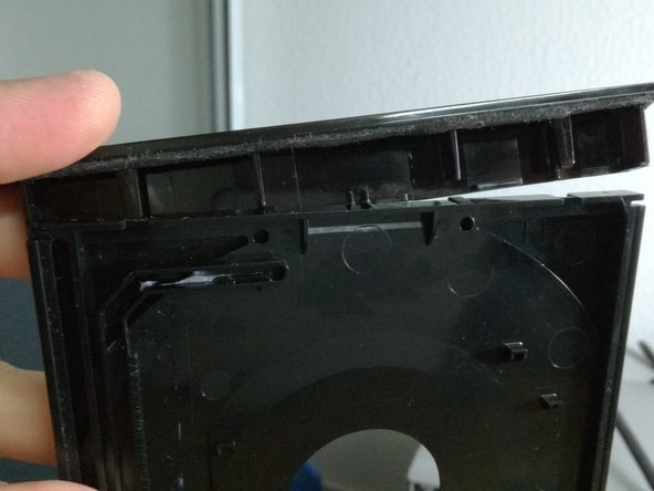

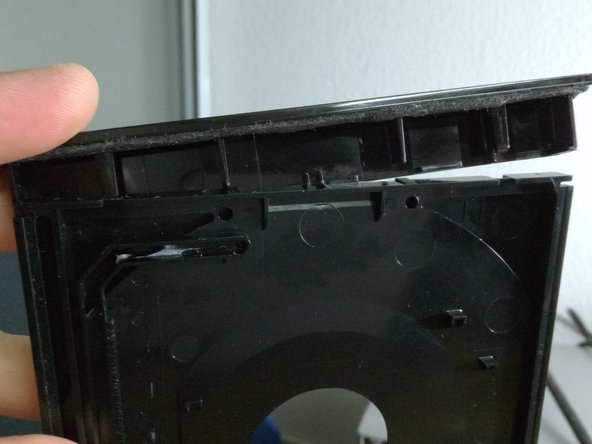

  4. Sony RDR HX750 HX950 Disassembly, Remove front Panel: crwdns2935265:04crwdnd2935265:01crwdnd2935265:03crwdne2935265:0 Sony RDR HX750 HX950 Disassembly, Remove front Panel: crwdns2935265:04crwdnd2935265:02crwdnd2935265:03crwdne2935265:0 Sony RDR HX750 HX950 Disassembly, Remove front Panel: crwdns2935265:04crwdnd2935265:03crwdnd2935265:03crwdne2935265:0
    • Insert the paper under each "click" to remove the front panel.
    • Once each "click" is loose, push the front panel gently.
    • The table of the compact disk has a little plastic piece in front that goes up to come out with a "click"

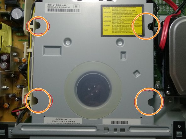

  5. Sony RDR HX750 HX950 Disassembly, Remove  DVD block: crwdns2935265:05crwdnd2935265:01crwdnd2935265:03crwdne2935265:0 Sony RDR HX750 HX950 Disassembly, Remove  DVD block: crwdns2935265:05crwdnd2935265:02crwdnd2935265:03crwdne2935265:0 Sony RDR HX750 HX950 Disassembly, Remove  DVD block: crwdns2935265:05crwdnd2935265:03crwdnd2935265:03crwdne2935265:0
    • Unplug the cables show in photo.
    • Disconnect the cable hidden on the side.
    • Remove the piece on the cd reader

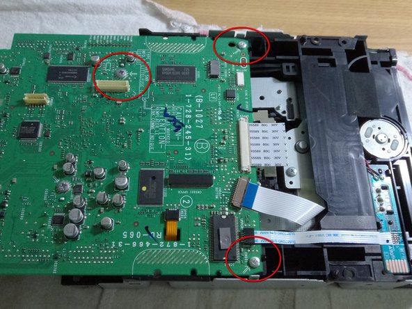

  6. Sony RDR HX750 HX950 Disassembly, Remove cover of dvd player: crwdns2935265:06crwdnd2935265:01crwdnd2935265:03crwdne2935265:0 Sony RDR HX750 HX950 Disassembly, Remove cover of dvd player: crwdns2935265:06crwdnd2935265:02crwdnd2935265:03crwdne2935265:0 Sony RDR HX750 HX950 Disassembly, Remove cover of dvd player: crwdns2935265:06crwdnd2935265:03crwdnd2935265:03crwdne2935265:0
    • Under the DVD block, remove the screws as shown.
    • Remove the screws on the board.
    • Now the laser can be accessed.

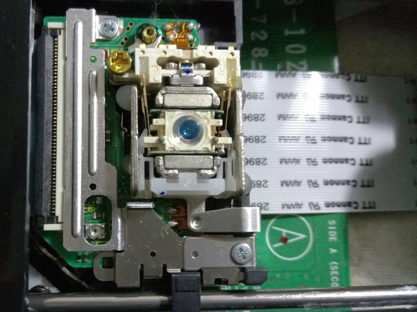

  7. Sony RDR HX750 HX950 Disassembly, Sony RDR HX750 laser: crwdns2935265:07crwdnd2935265:01crwdnd2935265:03crwdne2935265:0 Sony RDR HX750 HX950 Disassembly, Sony RDR HX750 laser: crwdns2935265:07crwdnd2935265:02crwdnd2935265:03crwdne2935265:0 Sony RDR HX750 HX950 Disassembly, Sony RDR HX750 laser: crwdns2935265:07crwdnd2935265:03crwdnd2935265:03crwdne2935265:0
    • Inserir instruções aqui.
To open this dvd recorder folow this tutorial
