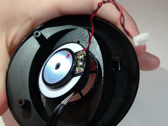

    4. Sony Pulse Elite Edition Speaker Replacement, Remove Speaker Housing: crwdns2935265:04crwdnd2935265:01crwdnd2935265:01crwdne2935265:0
      • Using tweezers, gently pry the red and black speaker wires from the attached socket.
    1. Sony Pulse Elite Edition Speaker Replacement, Speaker: crwdns2935265:05crwdnd2935265:01crwdnd2935265:02crwdne2935265:0 Sony Pulse Elite Edition Speaker Replacement, Speaker: crwdns2935265:05crwdnd2935265:02crwdnd2935265:02crwdne2935265:0
      • Locate the junction of the electrical speaker and the plastic speaker housing.
      • Use the spudger to sever the glue at this junction.
      • Remove the electrical speaker from the speaker housing.
    2. Sony Pulse Elite Edition Speaker Replacement: crwdns2935265:06crwdnd2935265:01crwdnd2935265:01crwdne2935265:0
      • Use super glue to fasten the replacement speaker into the speaker housing.
