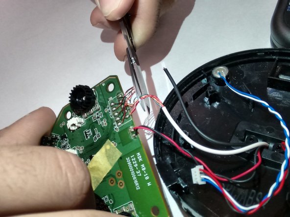

  8. Sony Pulse Elite Edition Motherboard Replacement, Fixed Wire Removal: crwdns2935265:08crwdnd2935265:01crwdnd2935265:02crwdne2935265:0 Sony Pulse Elite Edition Motherboard Replacement, Fixed Wire Removal: crwdns2935265:08crwdnd2935265:02crwdnd2935265:02crwdne2935265:0
    • Using wire cutters, cut all of the permanent wires from the motherboard.
    • Strip the wires on the ear piece portion about a quarter of an inch from their cut ends.
    • These will need need to be soldered to the new motherboard, so it will be easiest to cut the wires, 1/2" away from the motherboard.
  9. Sony Pulse Elite Edition Motherboard Replacement, Solder New Motherboard: crwdns2935265:09crwdnd2935265:01crwdnd2935265:01crwdne2935265:0
    • Strip the wires on the ends of the new motherboard wires about a half inch from the end.
    • Solder each individual wire from the new motherboard to the corresponding wire on the ear piece.
    • Completely wrap each solder joint with electrical tape so that the exposed wires only contact their corresponding wires.
    • Unintentional contact of non-corresponding wires can result in electrical fire and the failure of the device.
