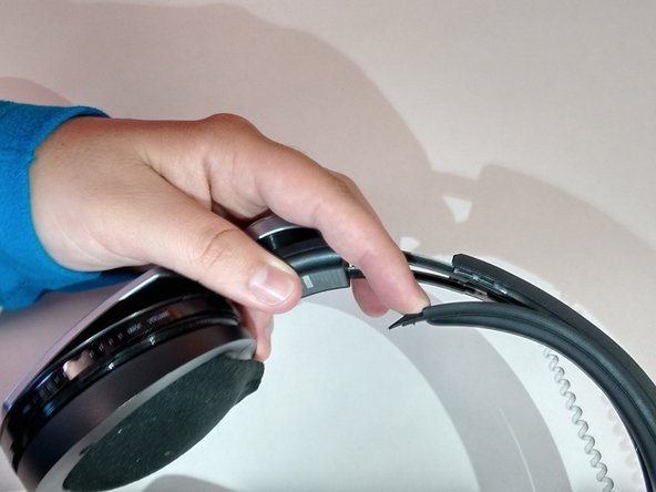

  3. Sony Pulse Elite Edition Headband Replacement, Rail Cushion Removal: crwdns2935265:03crwdnd2935265:01crwdnd2935265:03crwdne2935265:0 Sony Pulse Elite Edition Headband Replacement, Rail Cushion Removal: crwdns2935265:03crwdnd2935265:02crwdnd2935265:03crwdne2935265:0 Sony Pulse Elite Edition Headband Replacement, Rail Cushion Removal: crwdns2935265:03crwdnd2935265:03crwdnd2935265:03crwdne2935265:0
    • Using your thumb, slide the cushion on one of the two adjusting rails toward the closest speaker.
    • Once enough of the cushion has separated from the rail, pull the rest of it off.
    • Repeat the process for the other rail.

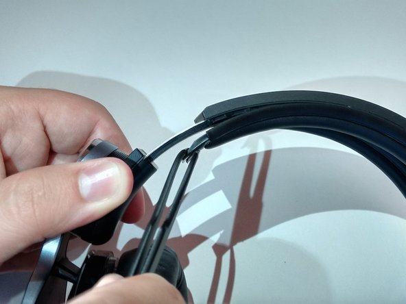

  4. Sony Pulse Elite Edition Headband Replacement, Slide Headband Off Rails: crwdns2935265:04crwdnd2935265:01crwdnd2935265:01crwdne2935265:0
    • Gently pull the headband away from one of the speaker component groups, as if expanding it. Continue pulling until it is completely off the track.
    • Remove the white and red wires from inside the headband.
    • Be sure to keep the two speakers close together since they are still linked via the speaker wires.
    • Repeat this process for the other side.
