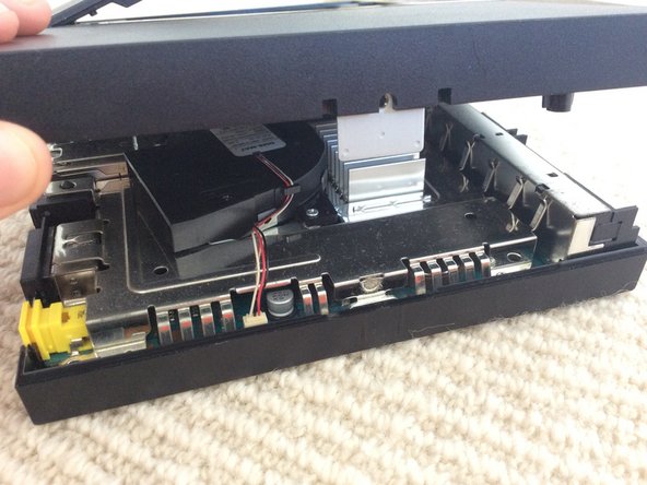

  5. Sony Playstation 2 SCPH-79002 - Front Cover Replacement, Taking off the front cover: crwdns2935265:05crwdnd2935265:01crwdnd2935265:02crwdne2935265:0 Sony Playstation 2 SCPH-79002 - Front Cover Replacement, Taking off the front cover: crwdns2935265:05crwdnd2935265:02crwdnd2935265:02crwdne2935265:0
    • Once you have unscrew them, gently take off the front cover of the Playstation 2.
  6. Sony Playstation 2 SCPH-79002 - Front Cover Replacement, Double check you took off the front cover correctly: crwdns2935265:06crwdnd2935265:01crwdnd2935265:01crwdne2935265:0
    • You should now see something like this.
