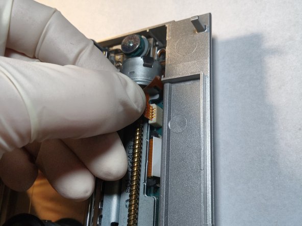

    • Now, there are 3 flat cables to disconnect. Caution: Some have a small clamp that must first be released, so that you can carefully pull them out.
    • Cable 1 can easily be pulled out. However, be careful not to damage it!
  11. Sony Playstation 2 SCPH-77004 Laser Replacement, Disconnecting the drive part 2: crwdns2935265:011crwdnd2935265:01crwdnd2935265:03crwdne2935265:0 Sony Playstation 2 SCPH-77004 Laser Replacement, Disconnecting the drive part 2: crwdns2935265:011crwdnd2935265:02crwdnd2935265:03crwdne2935265:0 Sony Playstation 2 SCPH-77004 Laser Replacement, Disconnecting the drive part 2: crwdns2935265:011crwdnd2935265:03crwdnd2935265:03crwdne2935265:0

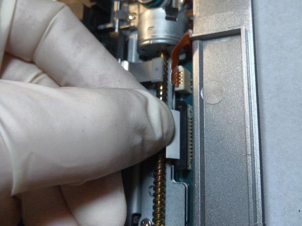

    • Cable 2 on the other hand, has a clamp. This must be carefully preyed up from both sides before you can disconnect the cable.
    • Cable 3 can easily be pulled out.

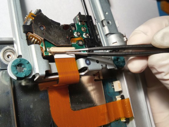

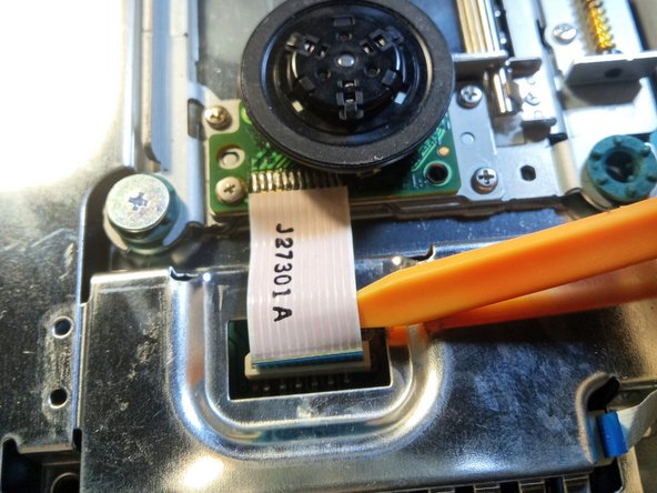

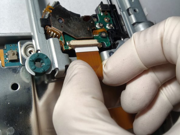

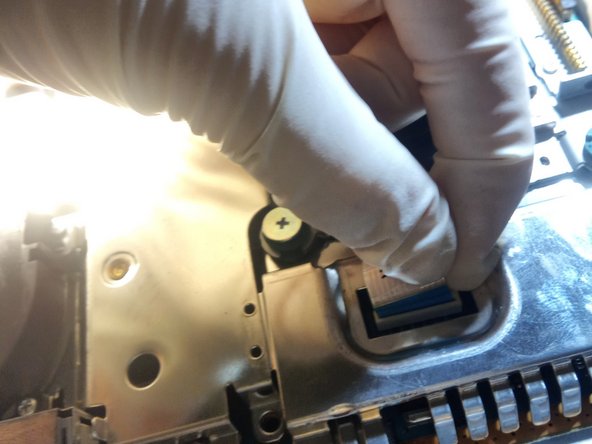

    • Now the drive, which is held in place by 3 screws, can be unscrewed.
    • Caution: It's still held on the underside by a flat cable! It's the cable for the laser head.
    • This cable also has a clamp that you can carefully pry open and release the cable from the interface.

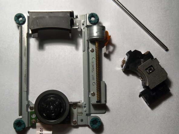

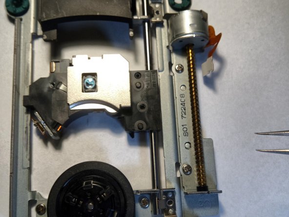

    • To release the laser unit from the bracket you must remove the 3 marked screws.
    • Attention: Don't loose the small brackets and screws!
  14. Sony Playstation 2 SCPH-77004 Laser Replacement, Removing the Laser Unit: crwdns2935265:014crwdnd2935265:01crwdnd2935265:02crwdne2935265:0 Sony Playstation 2 SCPH-77004 Laser Replacement, Removing the Laser Unit: crwdns2935265:014crwdnd2935265:02crwdnd2935265:02crwdne2935265:0
    • Now you can remove the rail from the laser unit, which it moves on while it reads the CD.

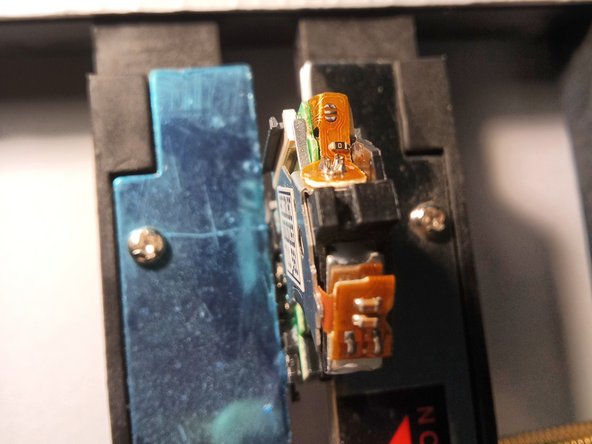

  15. Sony Playstation 2 SCPH-77004 Laser Replacement, New laser preparation / desoldering tin: crwdns2935265:015crwdnd2935265:01crwdnd2935265:03crwdne2935265:0 Sony Playstation 2 SCPH-77004 Laser Replacement, New laser preparation / desoldering tin: crwdns2935265:015crwdnd2935265:02crwdnd2935265:03crwdne2935265:0 Sony Playstation 2 SCPH-77004 Laser Replacement, New laser preparation / desoldering tin: crwdns2935265:015crwdnd2935265:03crwdnd2935265:03crwdne2935265:0

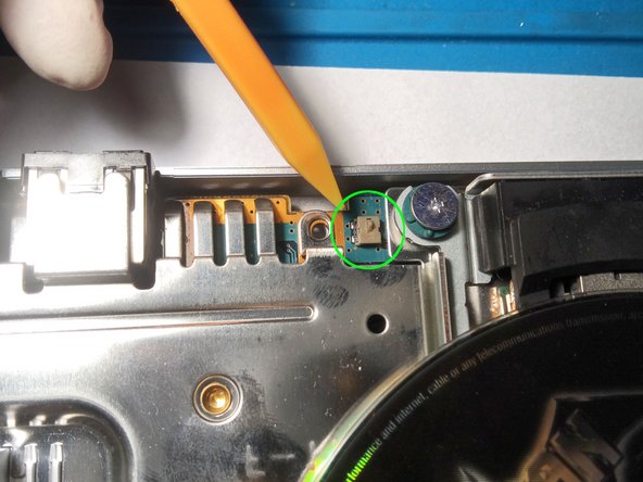

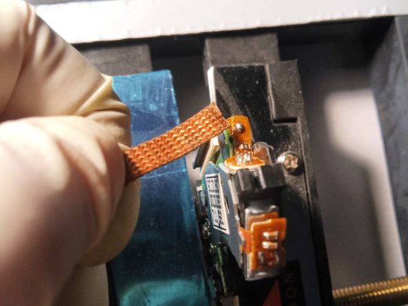

    • The new laser must be prepared. The small portion of solder at the area marked in green, must be removed with the help of desoldering wire. At this point, the new laser should look exactly like the old one.
    • Take the desoldering wire and the heated soldering iron in-hand, and remove the bit of solder from this part.
    • Finished! The new laser is ready to be installed! You're almost done! Now you just have to screw everything back together again in reverse order!
