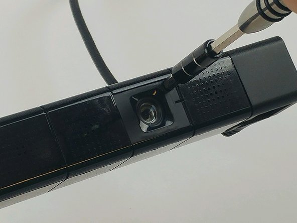

    5. Sony PlayStation Camera Microphone Array Replacement: crwdns2935265:05crwdnd2935265:01crwdnd2935265:02crwdne2935265:0 Sony PlayStation Camera Microphone Array Replacement: crwdns2935265:05crwdnd2935265:02crwdnd2935265:02crwdne2935265:0

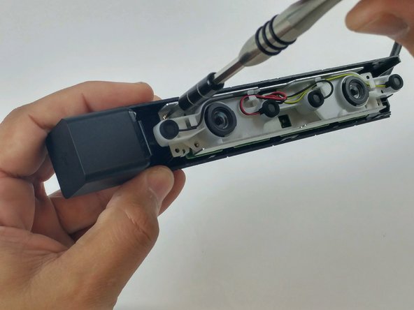

      • Using the PH0 sized screwdriver, remove two 3.2mm Phillips #0 screws, located under the coverplates.

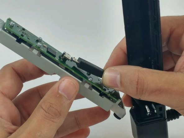

      • Using the PH0 sized screwdriver, remove the four 4.5mm Phillips #0 screws securing the circuit assembly to the device housing.
    8. Sony PlayStation Camera Microphone Array Replacement: crwdns2935265:08crwdnd2935265:01crwdnd2935265:03crwdne2935265:0 Sony PlayStation Camera Microphone Array Replacement: crwdns2935265:08crwdnd2935265:02crwdnd2935265:03crwdne2935265:0 Sony PlayStation Camera Microphone Array Replacement: crwdns2935265:08crwdnd2935265:03crwdnd2935265:03crwdne2935265:0

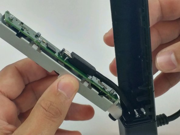

      • Lift the motherboard and frame from the plastic housing.
      • Disconnect the camera cable from the motherboard.

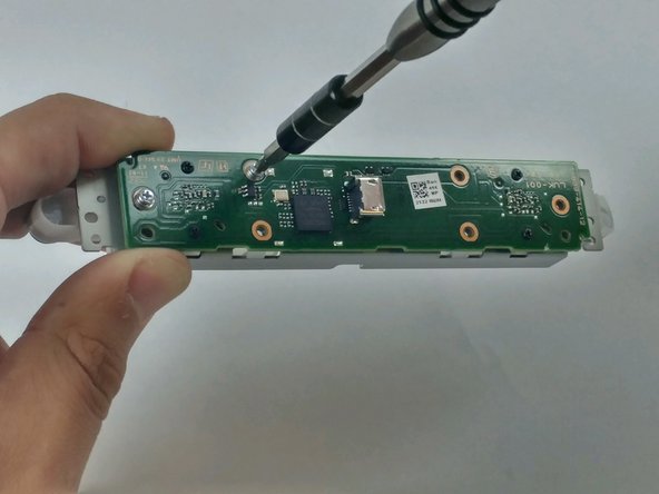

      • Using the PH0 sized screwdriver, remove the six 4.2mm Phillips #0 screws securing the motherboard to the metal frame.

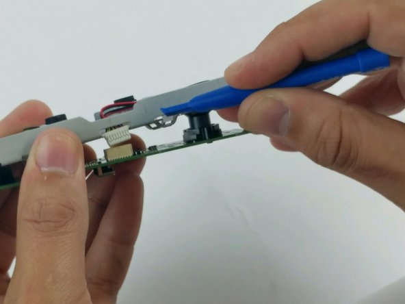

      • Using a plastic opening tool, disconnect the microphone array connector from the motherboard.

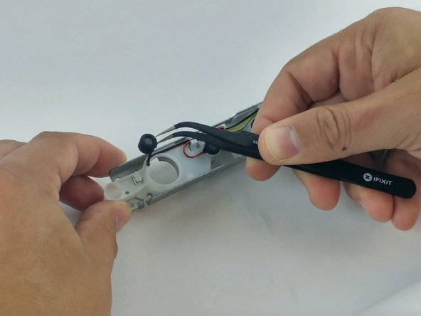

      • Using fine point tweezers, grab hold of each microphone, one at a time, and lift from the plastic frame.
      • Using care to not damage the wires, remove microphone array from the retaining tabs on the plastic frame.
