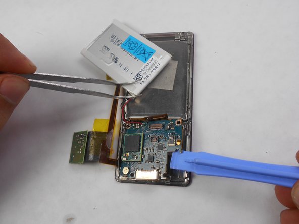

  6. Sony NWZ-E473 Front Button Replacement, Battery: crwdns2935265:06crwdnd2935265:01crwdnd2935265:02crwdne2935265:0 Sony NWZ-E473 Front Button Replacement, Battery: crwdns2935265:06crwdnd2935265:02crwdnd2935265:02crwdne2935265:0
    • Peel back the layer of tape along with the processor, which is located just below the battery, using the tweezers and the spudger.
  7. Sony NWZ-E473 Front Button Replacement: crwdns2935265:07crwdnd2935265:01crwdnd2935265:02crwdne2935265:0 Sony NWZ-E473 Front Button Replacement: crwdns2935265:07crwdnd2935265:02crwdnd2935265:02crwdne2935265:0
    • Slide a prying tool underneath the top portion of the battery and lift it from the case.
  8. Sony NWZ-E473 Front Button Replacement: crwdns2935265:08crwdnd2935265:01crwdnd2935265:01crwdne2935265:0
    • Remove the stickers from the battery terminals, which are on the underside of the battery.
  9. Sony NWZ-E473 Front Button Replacement: crwdns2935265:09crwdnd2935265:01crwdnd2935265:01crwdne2935265:0
    • Use a soldering iron to remove the wires from the red and the black terminals.

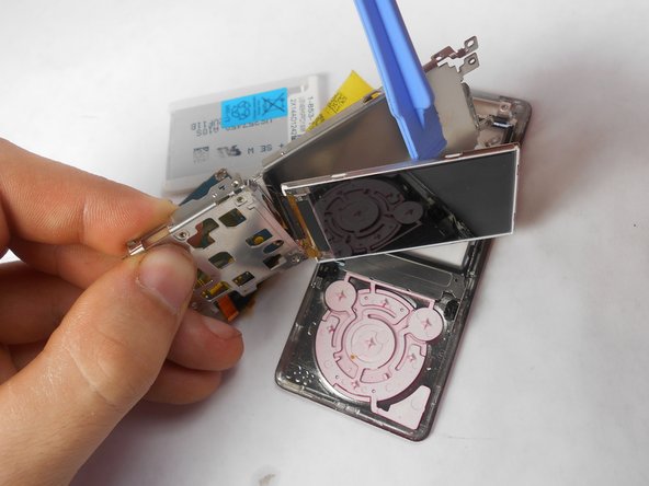

  17. Sony NWZ-E473 Front Button Replacement: crwdns2935265:017crwdnd2935265:01crwdnd2935265:02crwdne2935265:0 Sony NWZ-E473 Front Button Replacement: crwdns2935265:017crwdnd2935265:02crwdnd2935265:02crwdne2935265:0
    • Disconnect the metal shielding plate from the front panel with tweezers or a plastic opening tool.
  18. Sony NWZ-E473 Front Button Replacement: crwdns2935265:018crwdnd2935265:01crwdnd2935265:02crwdne2935265:0 Sony NWZ-E473 Front Button Replacement: crwdns2935265:018crwdnd2935265:02crwdnd2935265:02crwdne2935265:0
    • Use a plastic opening tool to remove the screen from metal back plate.
  19. Sony NWZ-E473 Front Button Replacement, Front Button: crwdns2935265:019crwdnd2935265:01crwdnd2935265:01crwdne2935265:0
    • Ensure that button connection is completely separated from the buttons.
  20. Sony NWZ-E473 Front Button Replacement: crwdns2935265:020crwdnd2935265:01crwdnd2935265:03crwdne2935265:0 Sony NWZ-E473 Front Button Replacement: crwdns2935265:020crwdnd2935265:02crwdnd2935265:03crwdne2935265:0 Sony NWZ-E473 Front Button Replacement: crwdns2935265:020crwdnd2935265:03crwdnd2935265:03crwdne2935265:0
    • Remove buttons from front display panel by pushing button display from the front of the device
